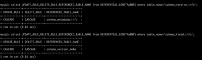

Verify that the two tables schema_version_info and schema_field_info have CASCADE ON UPDATE and CASCADE ON DELETE enabled.
This can be done by the below queries on information_schema database
select UPDATE_RULE,DELETE_RULE,REFERENCED_TABLE_NAME from REFERENTIAL_CONSTRAINTS where table_name='schema_version_info';
and
select UPDATE_RULE,DELETE_RULE,REFERENCED_TABLE_NAME from REFERENTIAL_CONSTRAINTS where table_name='schema_field_info';

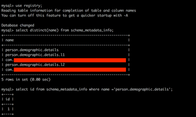

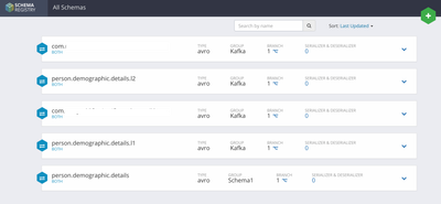

Below is the content of my schema registry before the delete operation and I am interested in deleting the person.demographic.details schema
Step 4
Identify the id of the schema to be deleted.
For this, you need to switch to the database provisioned to store the schema registry information. In my case it is 'registry' and issue the select query.
select id from schema_metadata_info where name ='person.demographic.details';

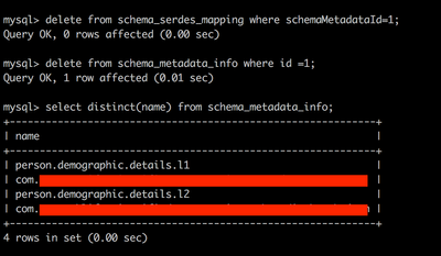

Delete the schema from schema_serdes_mapping based on the id we queried in step 4 above
delete from schema_serdes_mapping where schemaMetadataId=1;
Step 6
Delete the schema from schema_metadata_info based on the id we queried in step 4 above
delete from schema_metadata_info where id =1;

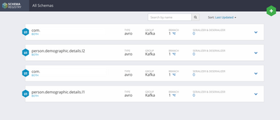

We observe that the schema has been deleted from the tables.
Step 7
Start the schema registry service via Ambari, and verify that the schema is deleted.

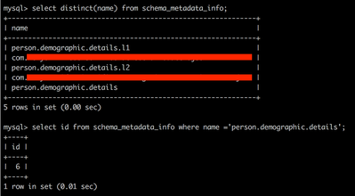

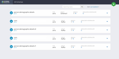

Optionally we can recreate the schema with the same name on the UI and explore the front-end and back-end to ensure the schema can be re-created with no issues.
We observe that the new schema was created with the same name and a different id.
