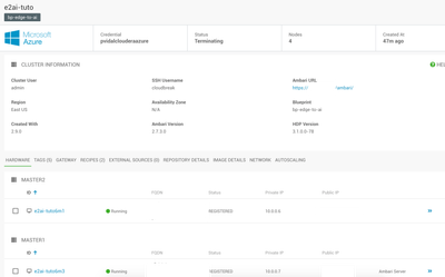

  • Step 3: Create cluster

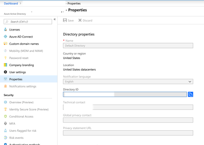

For the tenant ID, use the Azure AD Directory ID:

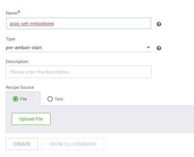

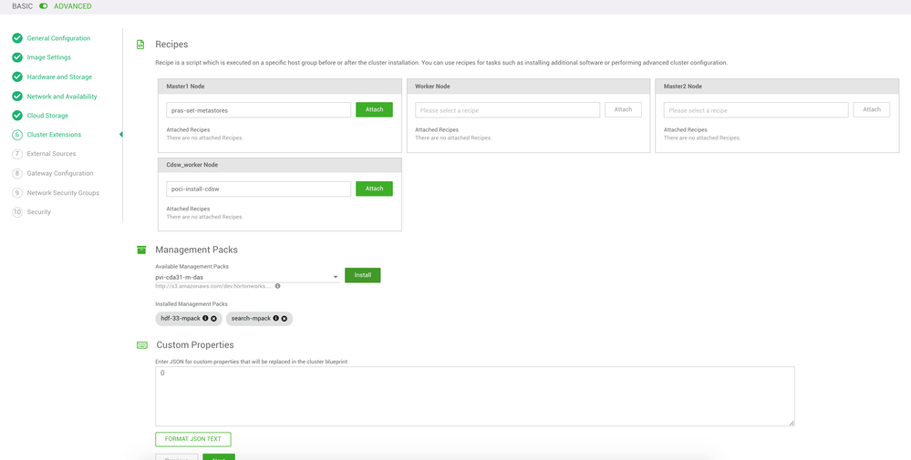

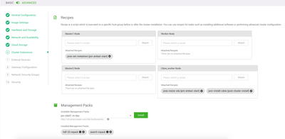

Step 2: Setup blueprint and cluster extensions

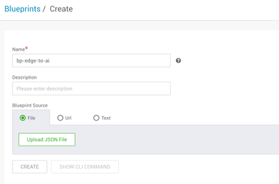

Blueprint
First upload the blueprint below:

Pre Ambari start recipe to setup metastores
#!/usr/bin/env bash

Pre Ambari start recipe to grow the root volume for the CDSW worker
#!/usr/bin/env bash

Post cluster install recipe to setup CDSW
#!/usr/bin/env bash

Management packs

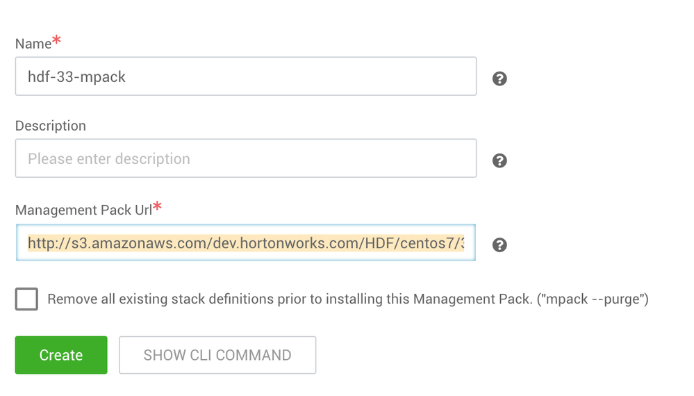

You will need two management packs for this setup, using the URL detailed below:

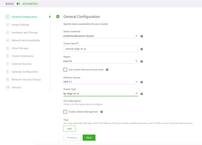

This step uses Cloudbreak's Create Cluster wizard, and is pretty self-explanatory following screenshots, but I will add specific parameters in text form for convenience
Note: Do not forget to toggle the advanced mode when running the wizard (top of the screen)

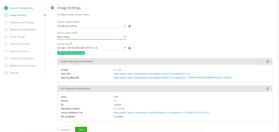

General Configuration
Image Settings

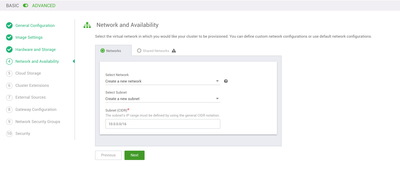

Network and Availability

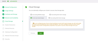

Cloud Storage
Cluster Extensions

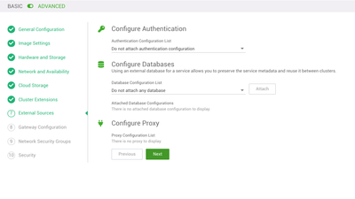

External Sources

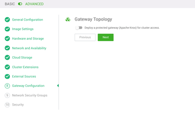

Gateway Configuration

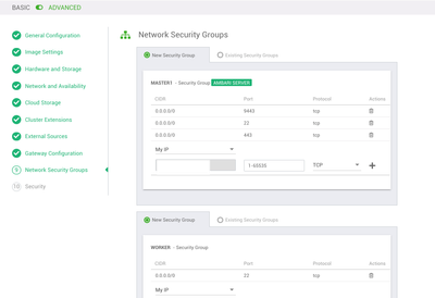

Network Security Groups

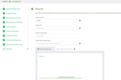

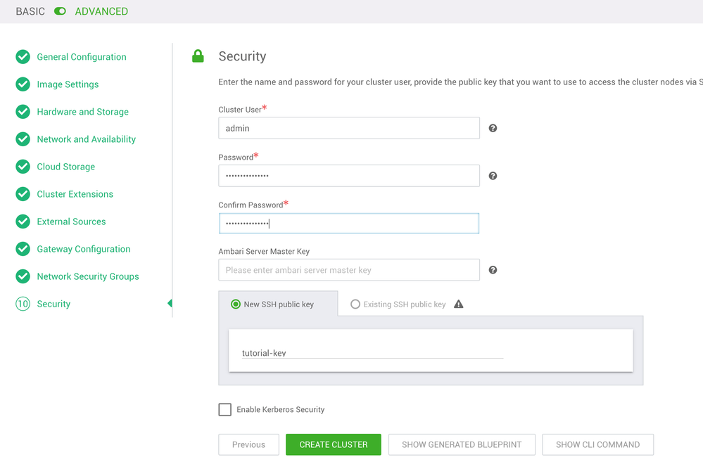

Security

After the cluster created, you should have access to the following screen in Cloudbreak:
You can now access Ambari via the link provided, and CDSW using http://[CDSW_WORKER_PUBLIC_IP].xip.io
