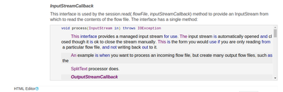

    Input and Output (I/O) for the contents of flow files is provided via the ProcessSession API and thus the "session" variable for ExecuteScript (see Part 1 for more information). One mechanism for this is to pass a callback object into a call to session.read() or session.write(). An InputStream and/or OutputStream will be created for the FlowFile object, and the callback object will be invoked using the corresponding callback interface, with the InputStream and/or OutputStream references passed in for use by the callback. There are three main callback interfaces, each with its own use case:
    InputStreamCallback
    This interface is used by the session.read( flowFile, inputStreamCallback) method to provide an InputStream from which to read the contents of the flow file. The interface has a single method:
    void process(InputStream in) throws IOException
    This interface provides a managed input stream for use. The input stream is automatically opened and closed though it is ok to close the stream manually. This is the form you would use if you are only reading from a particular flow file, and not writing back out to it.
    An example is when you want to process an incoming flow file, but create many output flow files, such as the SplitText processor does.
