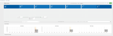

Apache NiFi 1.x Flow For CSV Ingest

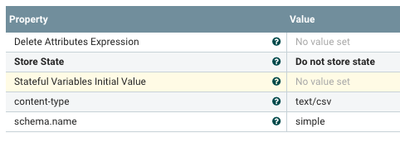

Set the Schema Name via Update Properties in NiFi

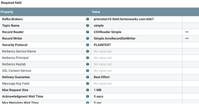

Publish Kafka Record Settings (need CSV Reader and AVRO Record Set Writer)

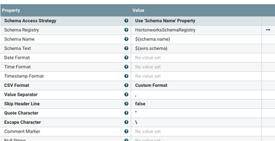

CSV Reader (Make sure your use the same Schema Registry, Access Strategy and Schema Name)27503-csvreader.png

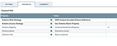

Avro Writer (Make sure you use the same Schema Registry, Write Strategy and Schema Name)

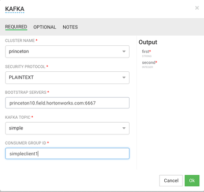

SAM Kafka Source:

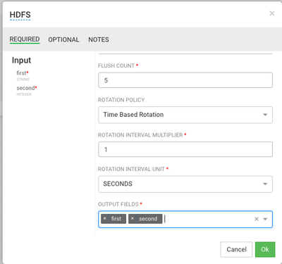

SAM HDFS Sink: Set a directory and what fields you want to output

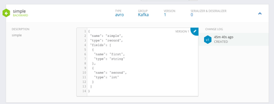

Create a New Schema in the Registry from this Schema
 "name": "simple",
 "type": "record",
 "fields": [
   "name": "first",
   "type": "string"
   "name": "second",
   "type": "int"
