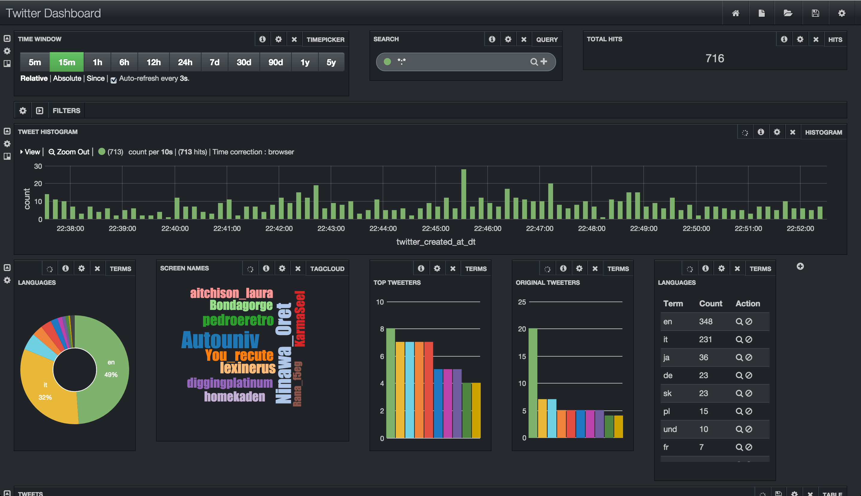

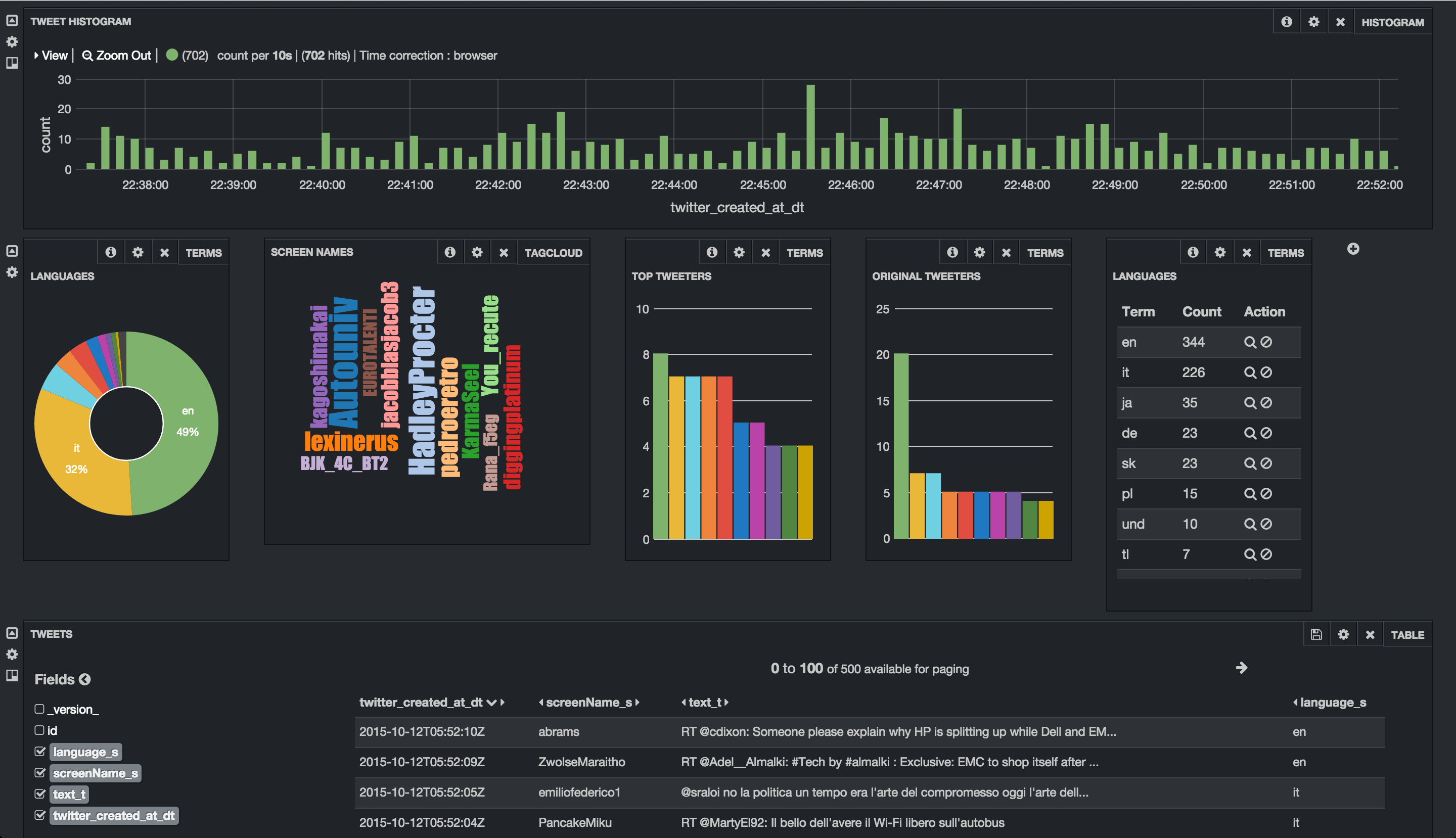

  • Visualize tweets in Solr using Banana dashboard

    • Setup the Banana dashboard by copying default.json to dashboard dir
    cd /opt/lucidworks-hdpsearch/solr/server/solr-webapp/webapp/banana/app/dashboards/
    mv default.json default.json.orig
    wget https://raw.githubusercontent.com/abajwa-hw/ambari-nifi-service/master/demofiles/default.json

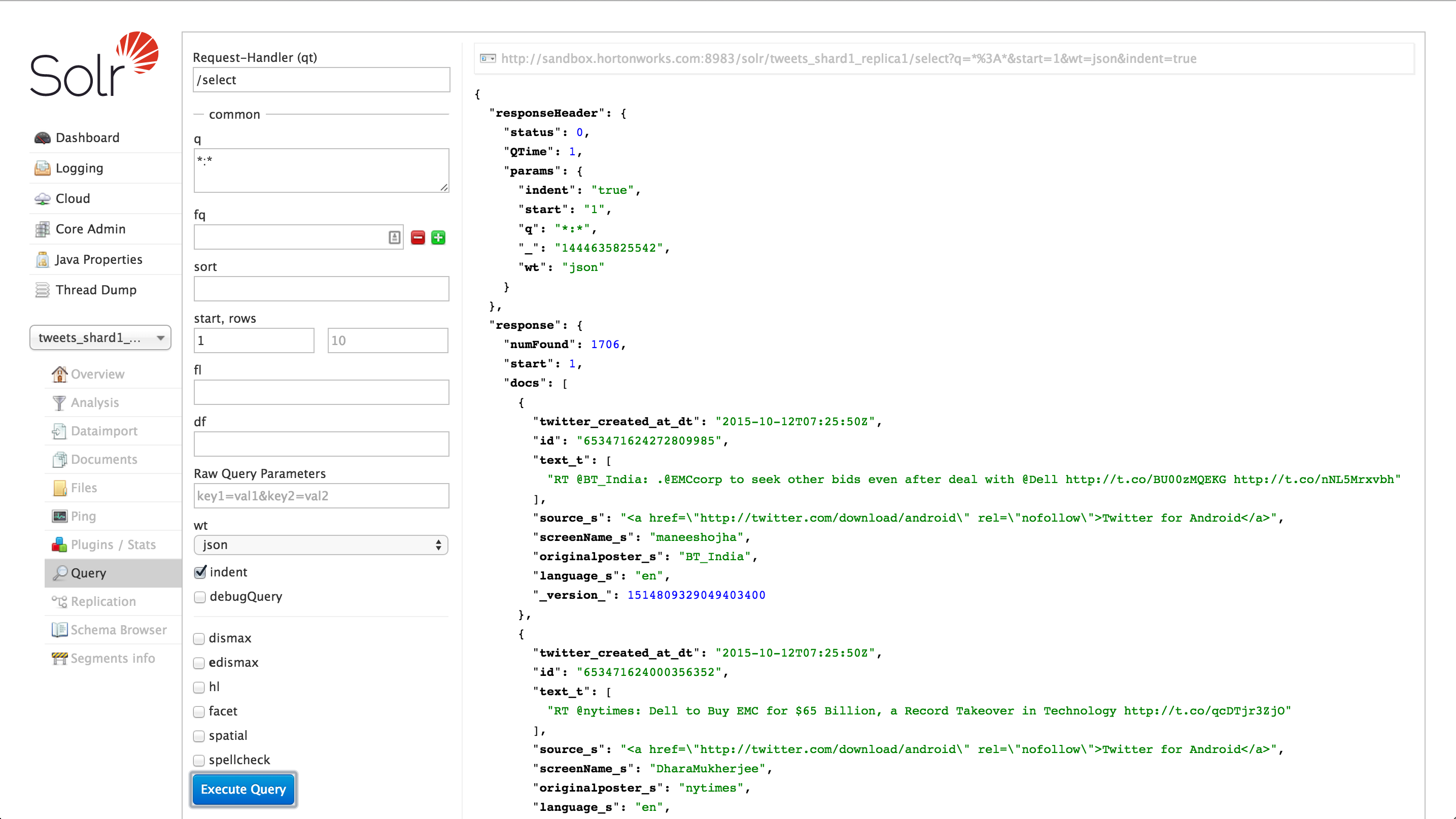

    • create a collection called tweets
    /opt/lucidworks-hdpsearch/solr/bin/solr create -c tweets    -d data_driven_schema_configs    -s 1    -rf 1
    • Solr setup is complete. Return to root user
    exit

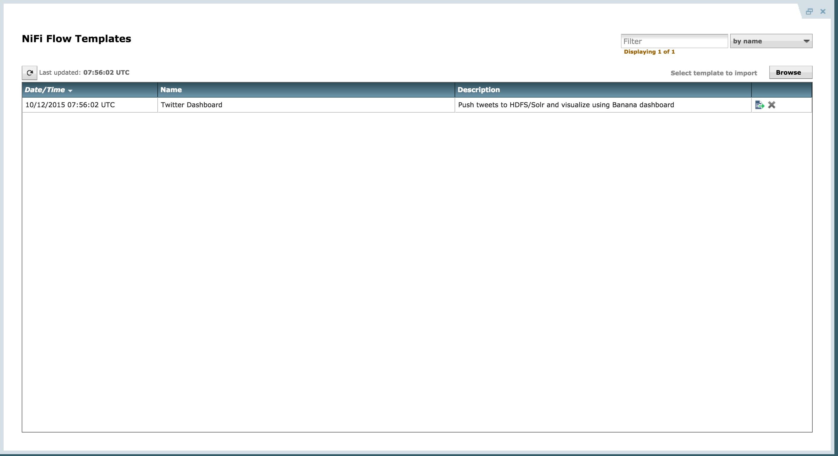

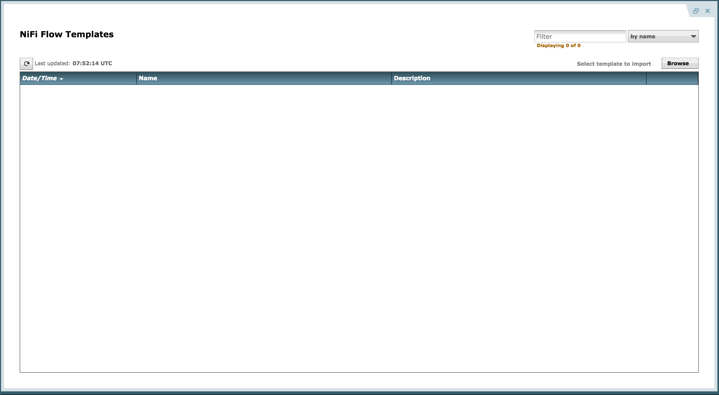

    • Import flow template info Nifi:
      • Import template by clicking on Templates (third icon from right) which will launch the 'Nifi Flow templates' popup Image
      • Browse and navigate to where ever you downloaded Twitter_Dashboard.xml on your local machine
      • Click Import. Now the template should appear: Image
      • Close the popup

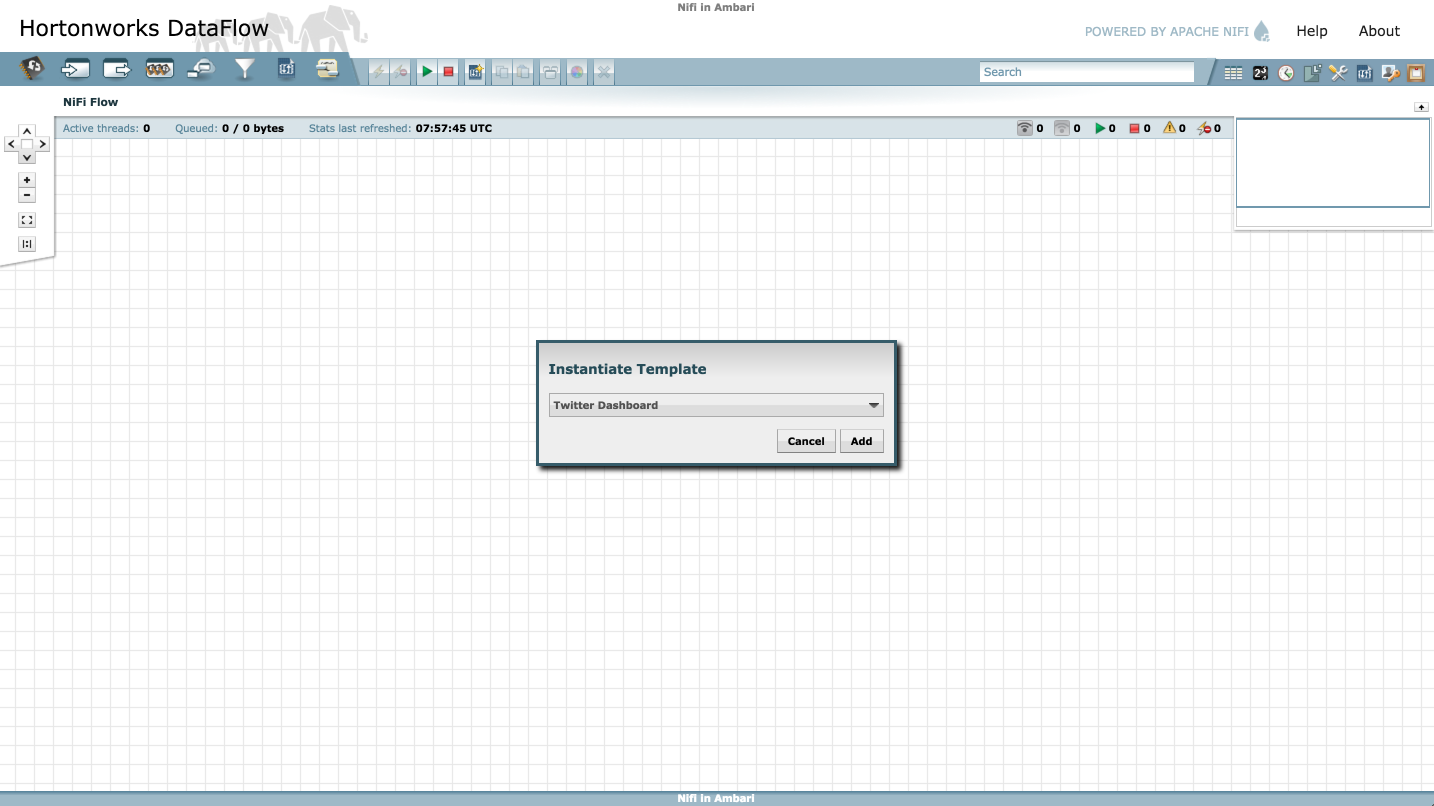

    • Instantiate the Twitter dashboard template:
      • Drag/drop the Template icon (7th icon form left) onto the canvas so that a picklist popup appears Image
      • Select 'Twitter dashboard' and click Add
      • This should create a box (i.e processor group) named 'Twitter Dashboard'. Double click it to drill into the actual flow

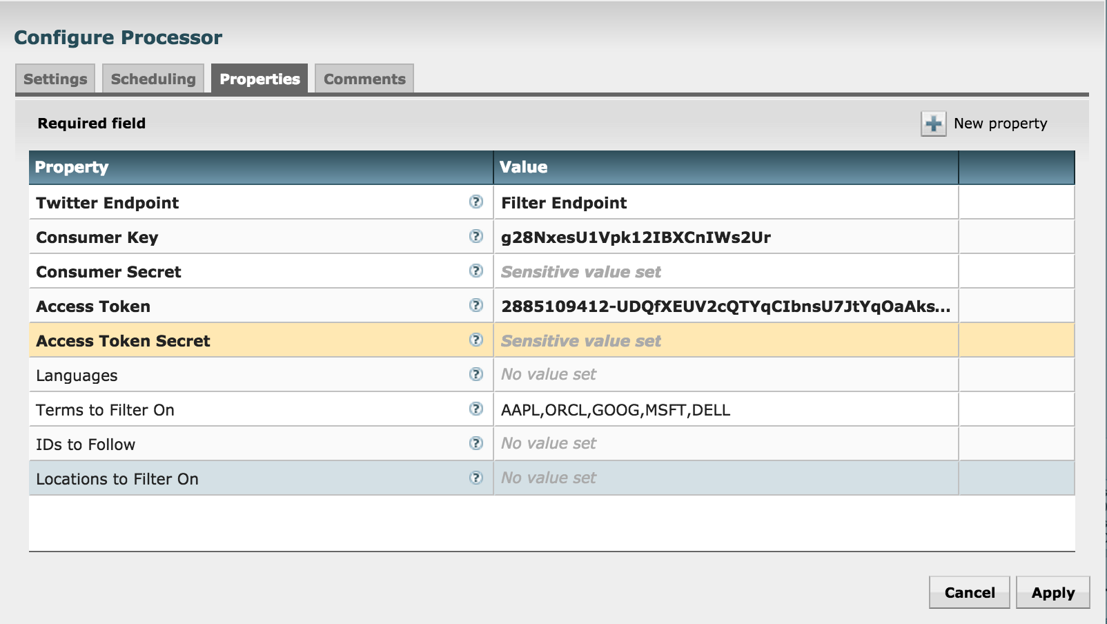

    • Configure GetTwitter processor
      • Right click on 'GetTwitter' processor (near top) and click Configure
        • Under Properties:
          • Enter your Twitter key/secrets
          • ensure the 'Twitter Endpoint' is set to 'Filter Endpoint'
          • enter the search terms (e.g. AAPL,GOOG,MSFT,ORCL) under 'Terms to Filter on'Image
    • Configure PutContentSolrStream processor
      • Writes the selected attributes to Solr. In this case, assuming Solr is running in cloud mode with a collection 'tweets'
      • Confirm the Solr Location property is updated to reflect your Zookeeper configuration (for SolrCloud) or Solr standalone instance
      • If you installed Solr via Ambari, you will need to append /solr to the ZK string in the 'Solr Location':

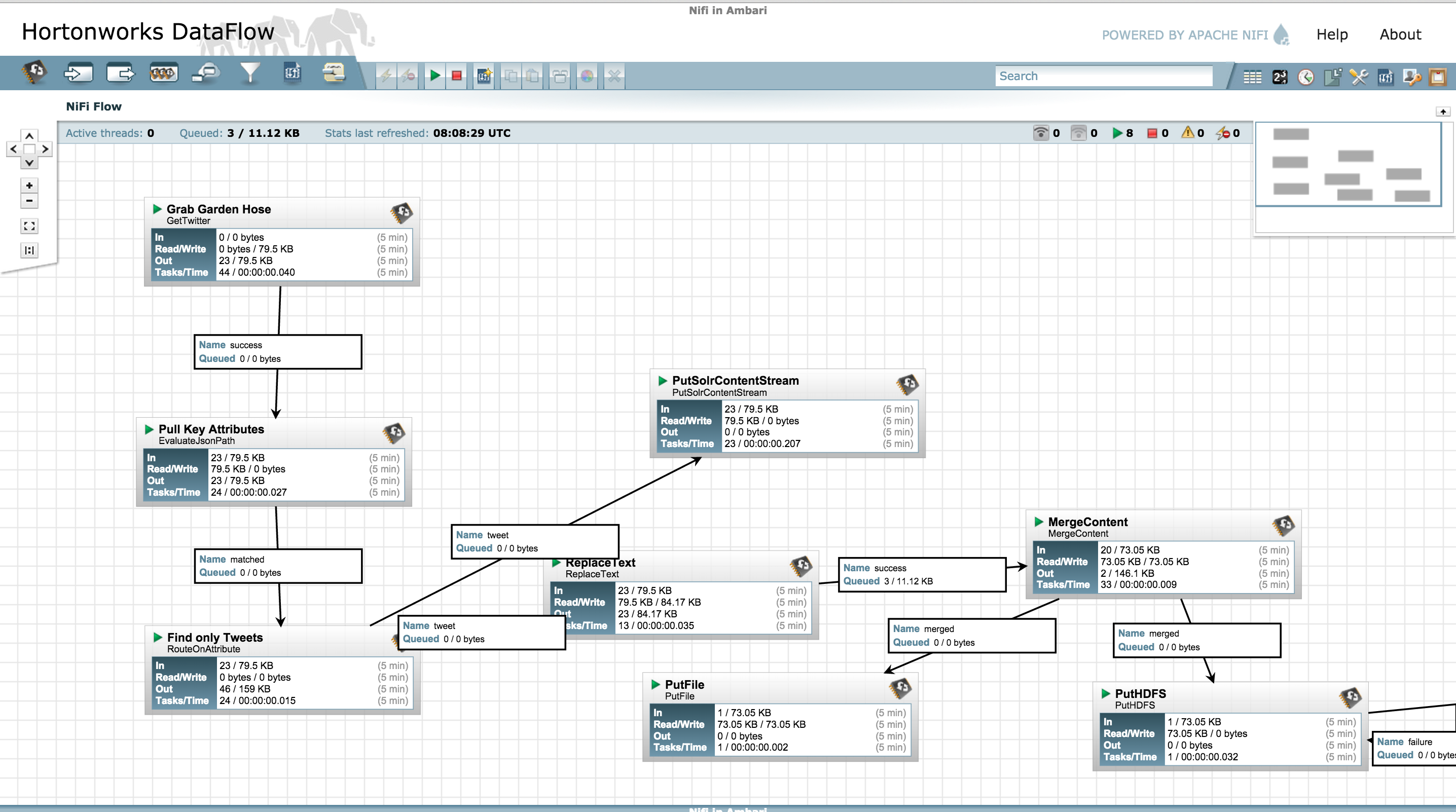

    • Click the Start button (green triangle near top of screen) to start the flow
    • After few seconds you will see tweets flowing Image

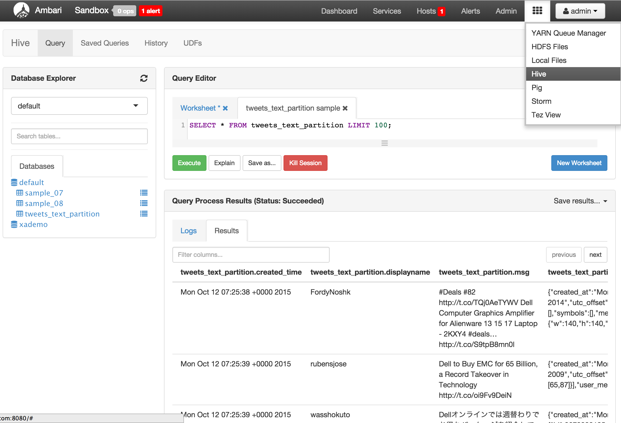

    • Create Hive table to be able to run queries on the tweets in HDFS
    sudo -u hdfs hadoop fs -chmod -R 777 /tmp/tweets_staging
    hive> create table if not exists tweets_text_partition(
      tweet_id bigint,
      created_unixtime bigint,
      created_time string,
      displayname string,
      msg string,
      fulltext string
    row format delimited fields terminated by "|"
    location "/tmp/tweets_staging";
Viewing results

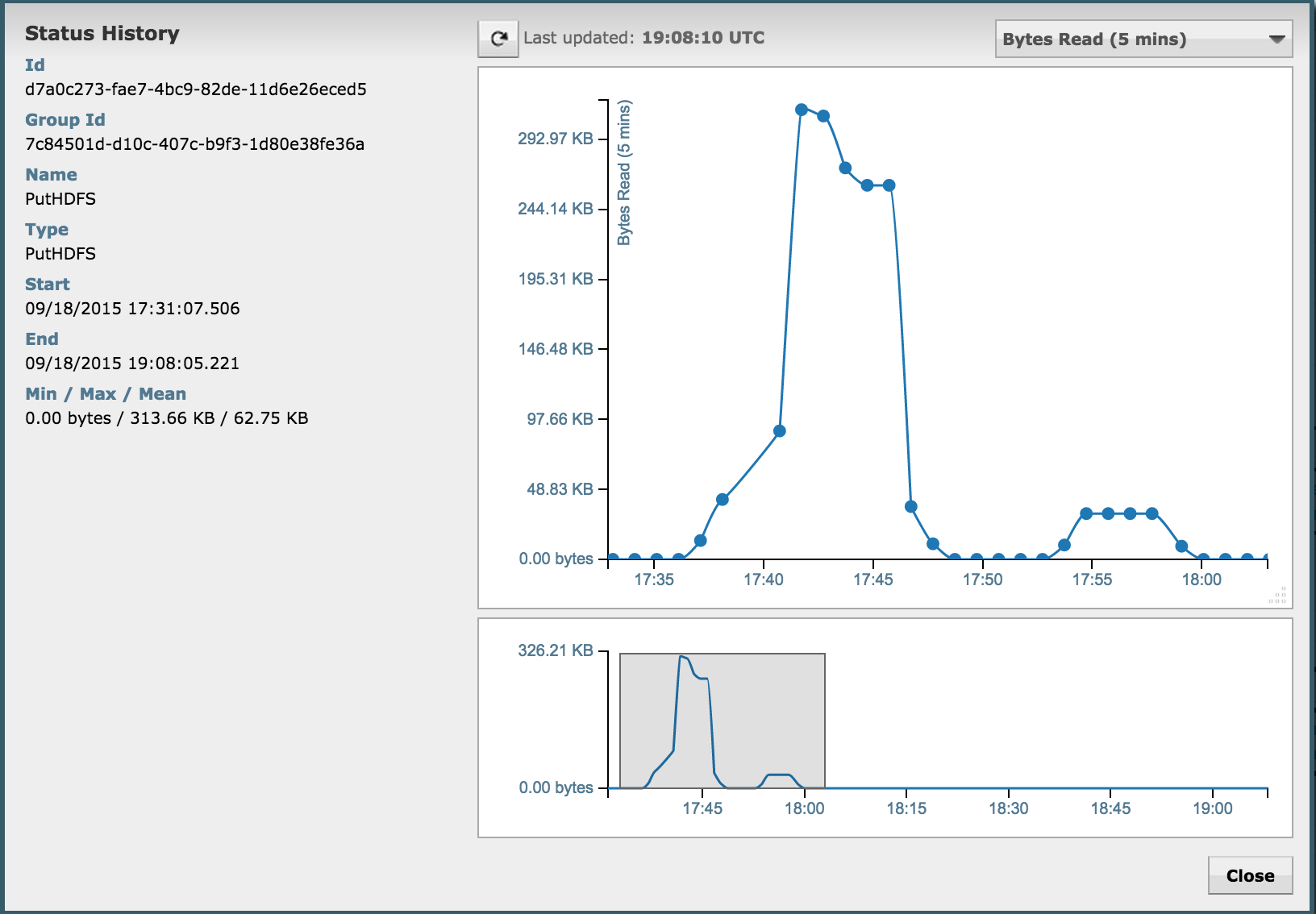

    • Flow statistics/graphs:

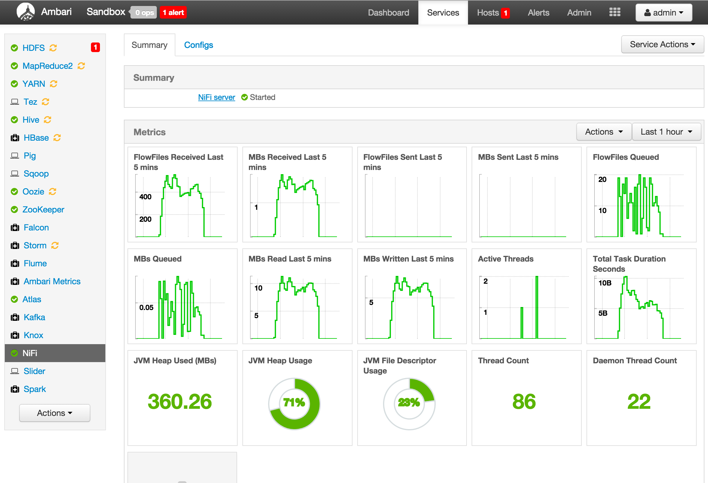

      • Right click on one of the processors (e.g. PutHDFS) and select click 'Stats' to see a number of charts/metrics: Image
      • You should also see Nifi metrics in Ambari (assuming you started Ambari metrics earlier)Image

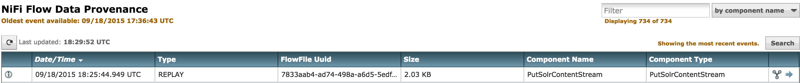

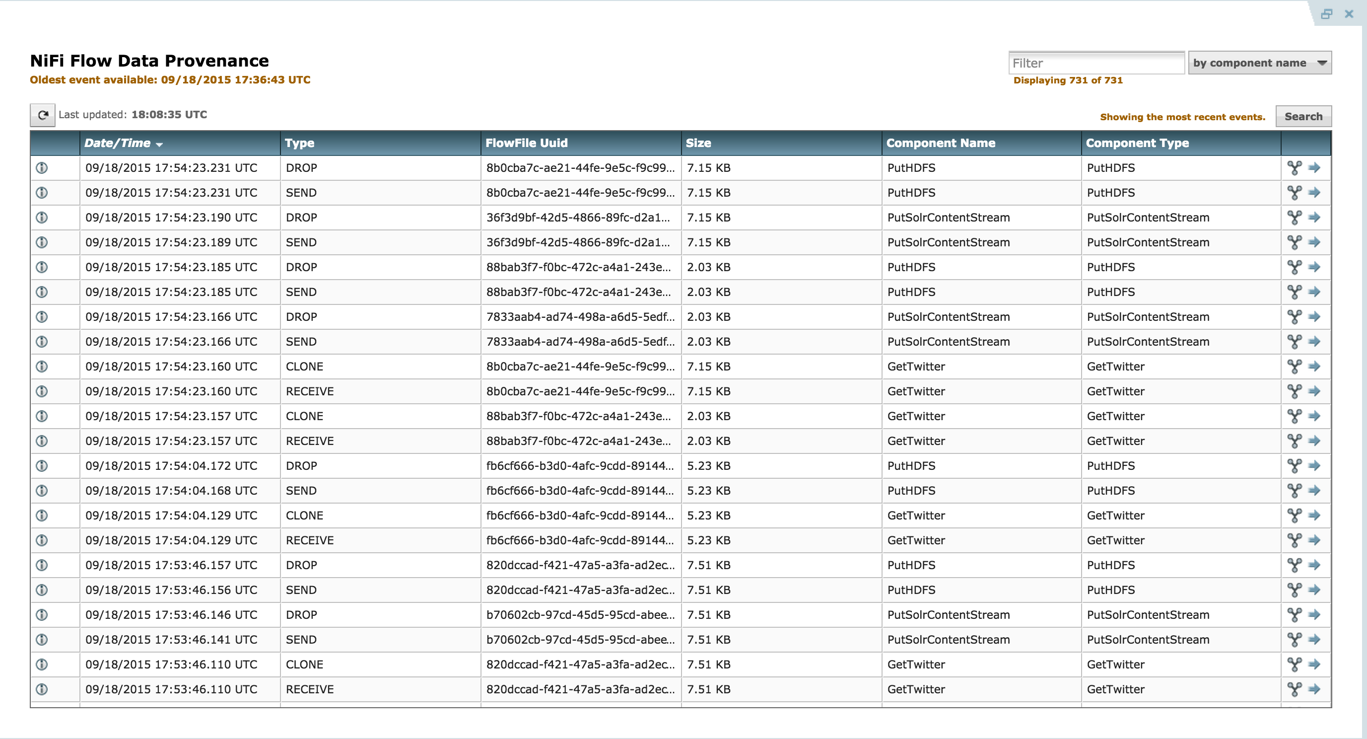

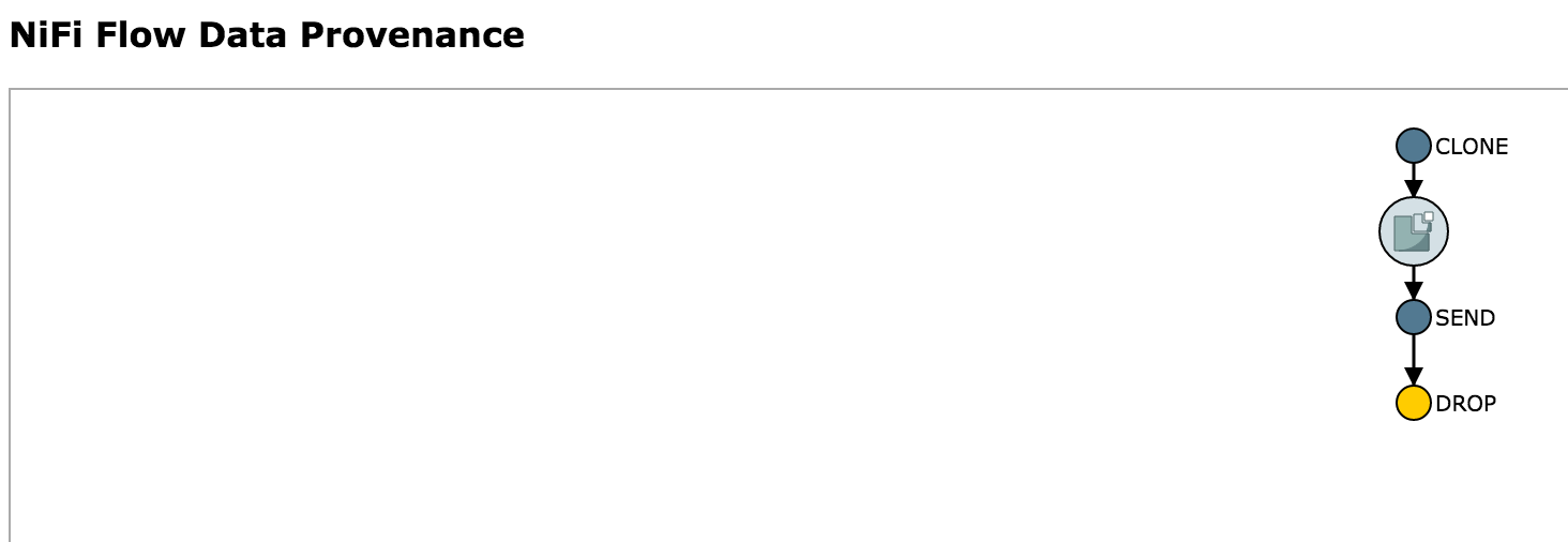

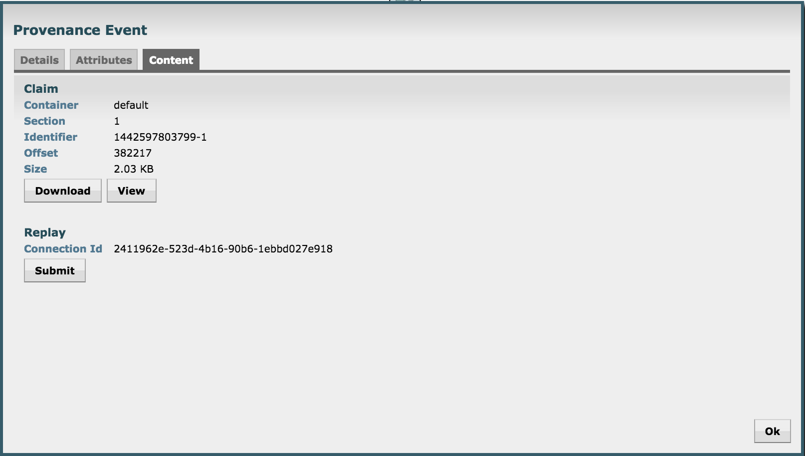

    • Data provenance in Nifi:
      • In Nifi home screen, click Provenance icon (5th icon from top right corner) to open Provenance page: Image
      • Click Show lineage icon (2nd icon from right) on any row Image
      • Right click Send > View details > Content Image

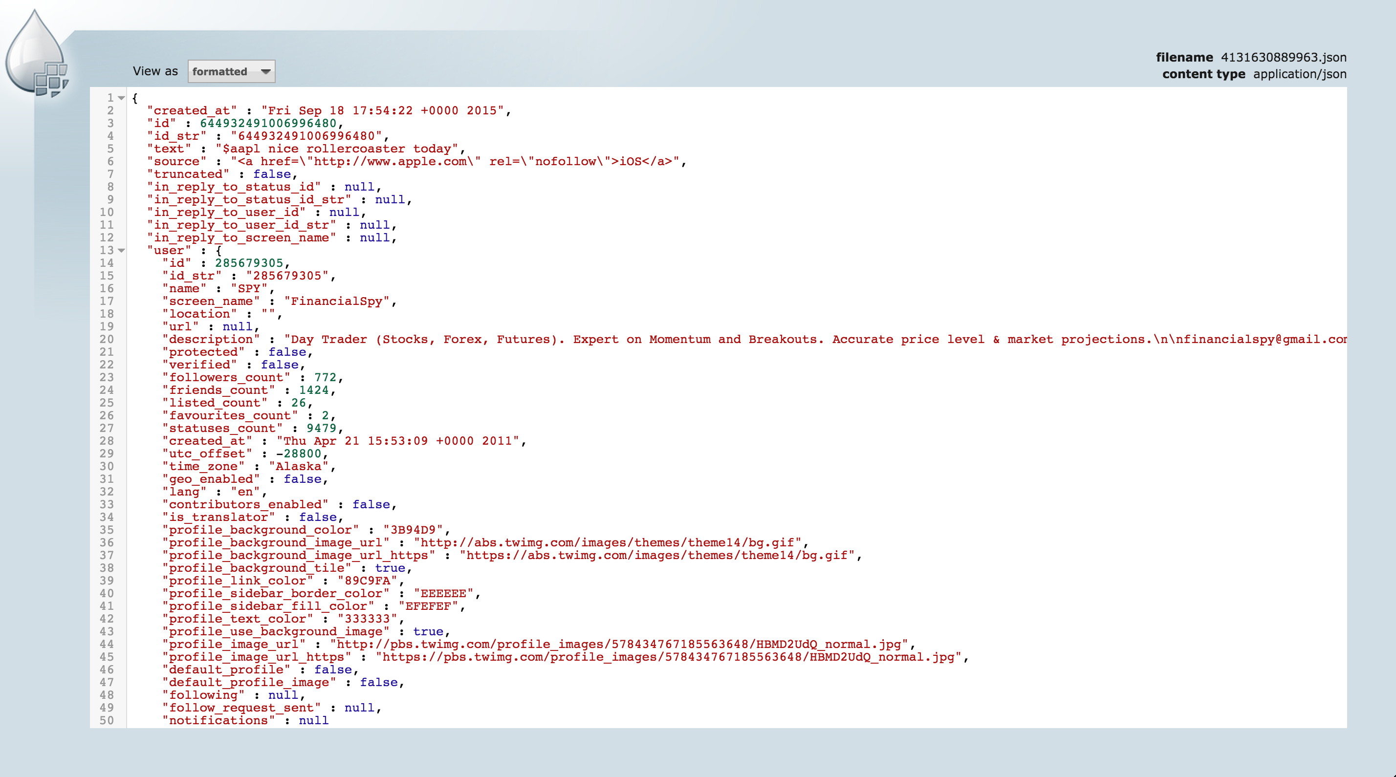

      • From here you can view the tweet itself by
        • Clicking Content > View > formatted Image
      • You can also replay the event by
        • Replay > Submit
      • Close the provenance window using x icon on the inner window

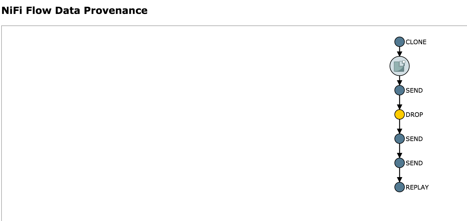

      • Notice the event was replayed Image
      • Re-open the the provenance window on the row you you had originally selected Image
      • Notice that by viewing and replaying the tweet, you changed the provenance graph of this event: Send and replay events were added to the lineage graph
      • Also notice the time slider on the bottom left of the page which allows users to 'rewind' time and 'replay' the provenance events as they happened.404-screen-shot-2015-11-05-at-51631-pm.png
      • Right click on the Send event near the bottom of the flow and select Details Image
      • Notice that the details of request to view the tweet are captured here (who requested it, at what time etc)
