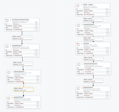

I am always looking for use cases, always. Yesterday I gave a talk at the IoT Fusion Conference in Philadelphia about IoT. I had a Raspberry Pi taking web camera images. I mentioned I wasn't pointing at people because they may not want to be photographed. I am concerned with privacy. It gave me the idea it would be cool to block people or other things from images. Then on queue, a great library shows up in github. Thanks to Minimaxir's Person Blocker, I can now use Apache NiFi to pull remove people from images. I did a couple of minor tweaks to his code to add OpenCV image capture and output some JSON information on what happened. I am running this on an OSX laptop, but at some point I'll move it to a Raspberry Pi, TinkerBoard or NVidia Jetson TX1.

The JSON produced as a record of the run has the following schema:
Schema
{ "type" : "record", "name" : "personblocker", "fields" : [ { "name" : "uuid", "type" : "string", "doc" : "Type inferred from '\"person_uuid_20180406203059f_b7ce1056-9d88-4e7f-b4dd-0e8c8d6e7086\"'" }, { "name" : "runtime", "type" : "string", "doc" : "Type inferred from '\"27\"'" }, { "name" : "host", "type" : "string", "doc" : "Type inferred from '\"server.local\"'" }, { "name" : "ts", "type" : "string", "doc" : "Type inferred from '\"2018-04-06 20:30:59\"'" }, { "name" : "ipaddress", "type" : "string", "doc" : "Type inferred from '\"10.1\"'" }, { "name" : "imagefilename", "type" : "string", "doc" : "Type inferred from '\"person_blocked_20180406203057\"'" }, { "name" : "originalfilename", "type" : "string", "doc" : "Type inferred from '\"images2/tx1_image_b9ebdd52-9a9f-45f0-b71c-a44c54f14b71_20180406203032.jpg\"'" } ] }
Example Output JSON
{"uuid": "person_uuid_20180406201647f_1d2c31bc-c232-4976-a350-747ffabf5afe", "runtime": "76", "host": "mymachine.local", "ts": "2018-04-06 20:16:47", "ipaddress": "10.1.1.12", "imagefilename": "person_blocked_20180406201632", "originalfilename": "images2/tx1_image_0309425f-12ca-4331-a810-21067cbaa8f2_20180406201531.jpg"}
run.sh
python3 -W ignore pb.py 2>/dev/null
