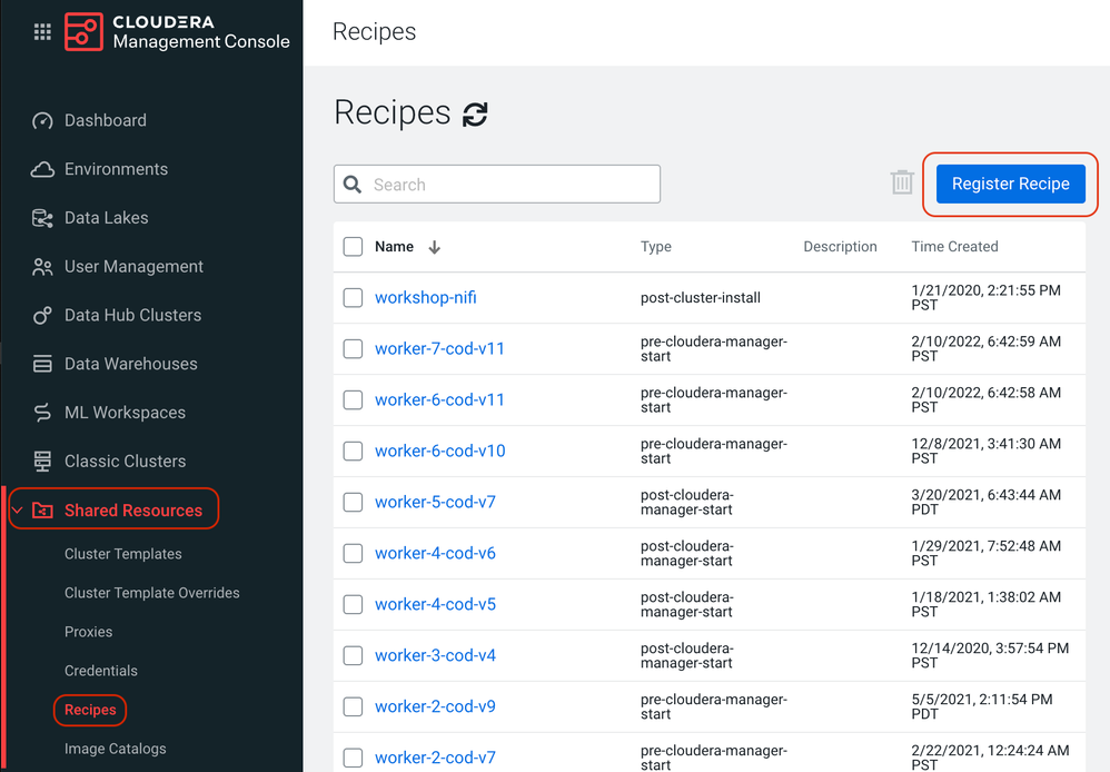

From the CDP Management Console, navigate to Recipes, under Shared Resources. Then click Register Recipe.
Next, enter the name of your recipe in the first box, which contains the text "Enter Environment Name". Don't ask me why it says 'Environment' rather than 'Recipe,' I don't have a good answer. Maybe when you read this it will have changed to something more intuitive.

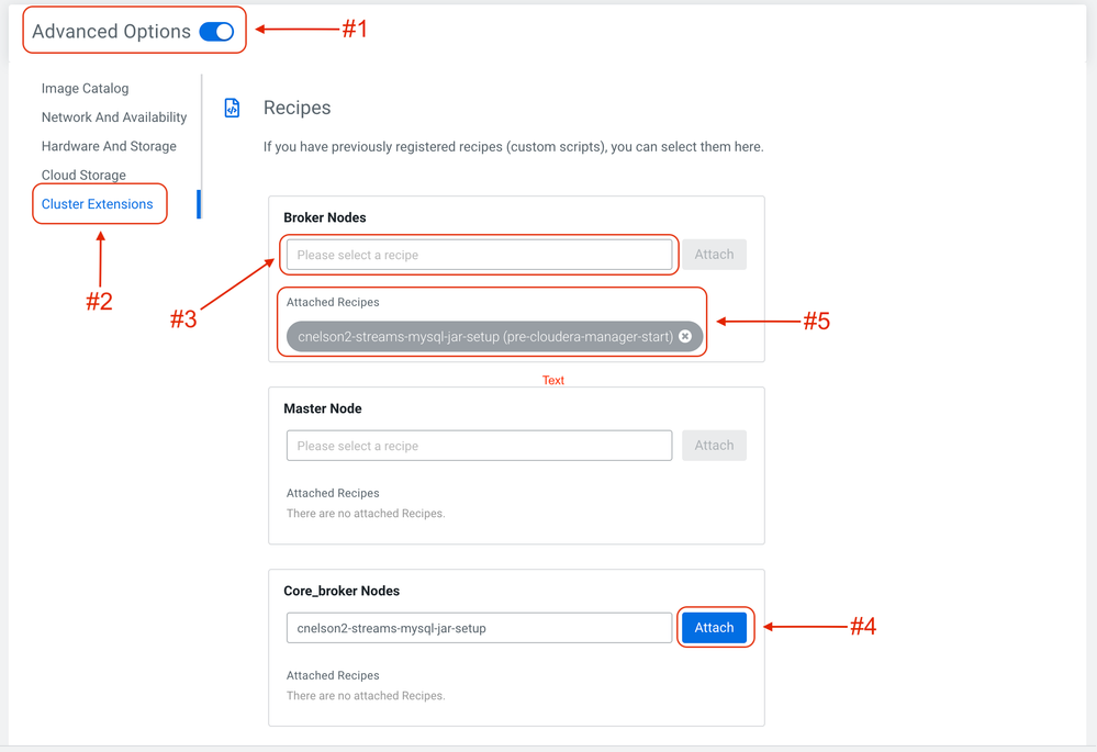

My recipe is designed to work with a Streams Messaging data hub, so we'll have to create one.  But there is a new step that we must take before we click the Provision Cluster button.
  1. Under Advanced Options (#1 in the diagram)...
  2. Click on the Cluster Extensions (#2 in the diagram)
  3. Our recipe needs to run on the broker nodes, so let's attach the recipe to brokers and core brokers. In the box labeled "Please select a recipe" (#3 in the diagram) you can start typing the name of your recipe until you find it.
  4. Once you have your recipe selected, click Attach (#4 in the diagram).
  5. It will then become a chip under the Attached Recipes section for that node type (#5 in the diagram).
  6. Do this for all the node types you upon which want your recipe applied.
  7. Now provision your cluster
