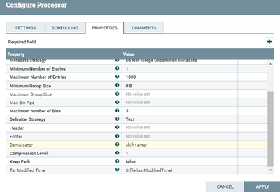

I am afraid this is very basic question but could not find an answer after spending a couple of hours. So I post the question here.
I'd like to add newlife when merging different csv flowfile with MergeContent so that output would be in right shape.
I stumbled upon a couple of articles but none of them did not work like the following link.
Here is my configuration.
I tried shift+enter, \n and so on, but could not get the output which I need..
I super appreciate if you tell me how to do this.
Thank you in advance

1) Demarcator, use
${literal(' '):unescapeXml()}
2) Delimiter Strategy = Text

Thanks, you saved my day.
Its also useful for merging multiple json files in a single jsonlines file.
cool!!
