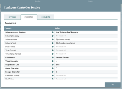

Configure your CSVReader like below
And your JSONRecordSetWritter like below
I tried it on your flow/data and it's working.

From the documentation of the AvroSchemaRegistry it looks like the actual schema should be given to the registry:
'value' represents the textual representation of the actual schema following the syntax and semantics of Avro's Schema format.
${inferred.avro.schema} is an attribute of the flow file and doesn't make sens for the registry.
To implement your use case, you should use "use schema text property" as a schema access strategy. It's more suitable for your use case with dynamic schemas. This way, the schema can be read from the flow file and used for the conversion.
A schema registry is more for governance so you will be adding and managing schemas manually.
Dos this helps?
