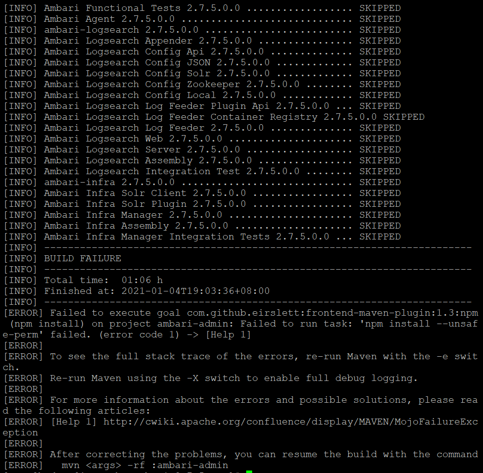

按照官方链接步骤执行到这一步:mvn -B clean install rpm:rpm -DnewVersion=2.7.5.0.0 -DbuildNumber=5895e4ed6b30a2da8a90fee2403b6cab91d19972 -DskipTests -Dpython.ver="python >= 2.6"
报错:
[ERROR] Failed to execute goal com.github.eirslett:frontend-maven-plugin:1.3:npm                                                                              (npm install) on project ambari-admin: Failed to run task: 'npm install --unsaf                                                                             e-perm' failed. (error code 1) -> [Help 1]
[ERROR]
[ERROR] To see the full stack trace of the errors, re-run Maven with the -e swit                                                                             ch.
[ERROR] Re-run Maven using the -X switch to enable full debug logging.
[ERROR]
[ERROR] For more information about the errors and possible solutions, please rea                                                                             d the following articles:
[ERROR] [Help 1] http://cwiki.apache.org/confluence/display/MAVEN/MojoFailureExc                                                                             eption
[ERROR]
[ERROR] After correcting the problems, you can resume the build with the command
[ERROR]   mvn <args> -rf :ambari-admin
希望有人能帮忙看一下,不胜感激,谢谢!
官网步骤:https://cwiki.apache.org/confluence/display/AMBARI/Installation+Guide+for+Ambari+2.7.5

您好,请看一看下面的解决办法[1]:
"12. Error
If npm is executed under the root account, it will change the uid to the current account, or the value of the uid is obtained from the user configuration file, and the default value of uid is nobody. So when you run npm install under the root account, you need to change unsafe-perm Option plus.
Solve (and then re-edit):
# find ~/.m2/repository/ -name "*.lastUpdated" -exec rm -rf {} \;
# mvn -B clean install rpm:rpm -DnewVersion=2.7.3.0.0 -DskipTests -Dpython.ver="python >= 2.6" -Drat.skip=true -X -rf :ambari-admin"
[1] https://www.programmersought.com/article/72684156755/
