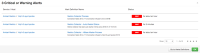

I am on Ambari Version 2.2.0.0 and did a fresh install of hadoop.
Whenever I start my hadoop services I get the following warnings and my metrics collector is shutting down (all other hadoop services are fine):
I attached all the logs from the ambari-metrics-collector directory in the attached zip.
Any help is appreciated!

It looks like your Metrics Collector cannot start because the HBase Master is not coming up. Just to make sure you're running a non-kerberized environment with a single Namenode, right? Are you using Metrics in distributed or embedded mode?
Could you please validate and post this configuration => hbase.rootdir
Your HBase Master log files show a connection refused when the HBase Master is trying to connect to the Namenode
2016-01-27 18:36:57,189 FATAL [hdp1n3:61300.activeMasterManager] master.HMaster: Unhandled exception. Starting shutdown. java.net.ConnectException: Call From hdp1n3/XXXXXXXXX to hdp1n3.aye1vpcdev:8020 failed on connection exception: java.net.ConnectException: Connection refused; For more details see: http://wiki.apache.org/hadoop/ConnectionRefused at sun.reflect.NativeConstructorAccessorImpl.newInstance0(Native Method) at sun.reflect.NativeConstructorAccessorImpl.newInstance(NativeConstructorAccessorImpl.java:62) at sun.reflect.DelegatingConstructorAccessorImpl.newInstance(DelegatingConstructorAccessorImpl.java:45) at java.lang.reflect.Constructor.newInstance(Constructor.java:422) at org.apache.hadoop.net.NetUtils.wrapWithMessage(NetUtils.java:792) at org.apache.hadoop.net.NetUtils.wrapException(NetUtils.java:732) at org.apache.hadoop.ipc.Client.call(Client.java:1431) ... at java.lang.Thread.run(Thread.java:745) Caused by: java.net.ConnectException: Connection refused at sun.nio.ch.SocketChannelImpl.checkConnect(Native Method) at sun.nio.ch.SocketChannelImpl.finishConnect(SocketChannelImpl.java:717) ...
Is this the hostname of your namenode "hdp1n3.aye1vpcdev:8020"?
Can you access the HDFS from the Metrics Collector node?

Hi Jonas, thanks, this was exactly the issue ... I switched from Embedded to Distributed Mode and by doing that, the default value for hbase.rootdir was pointing to the wrong note ... now everything is working as expected! Thanks again for your feedback, highly appreciated!
