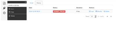

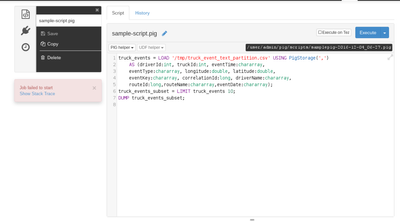

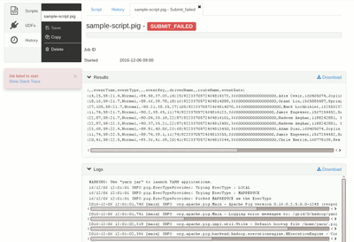

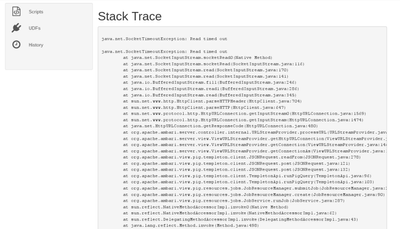

Something new I've noted after several tries is that even when I always get the error, sometimes the results are show correctly if I go to the execution details and sometimes they are empty. I'm including some screenshots to illustrate the situation.
Script exec error:
Stack trace:
History job error:
Job details: script results are OK (this happens only sometimes)
