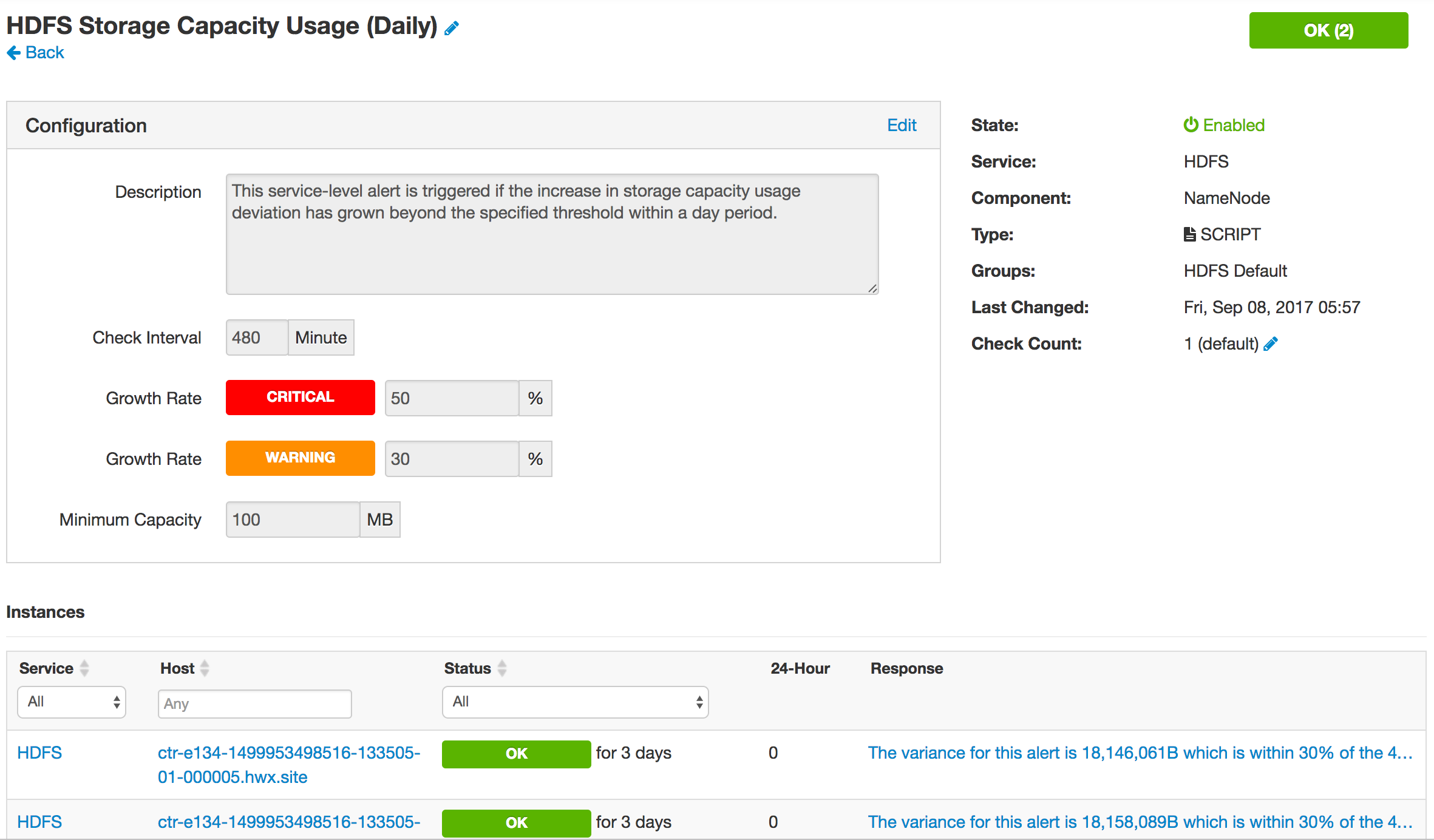

Created on 09-11-2017 09:28 PM - edited 08-18-2019 01:19 AM

Thanks for the screenshot. Need more clarity. Given that you are saying that you are getting the error :
No Under Replicated Blocks
No failed Disk Volumes.
Are you getting this error in alert ?
A working alerts (HEALTH/CRITICAL/WARN) looks like this (sample)
Refer instance and response section.
Can I have the full screenshot having instance and response section ?

Given that its coming as CRITICAL alert, this doesn't match with 50% growth rate mentioned in alert as per the 1st screenshot. This doesn't look correct, as its assuming CRITICAL threshold to be less than 25%.
Can you enable and disable the alerts once, if that refreshes ?
