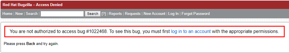

I notice in your error log its the SSL on Ambari server causing the problem.
INFO 2017-08-22 13:33:55,016 NetUtil.py:67 - Connecting to https://F.Q.D.N:8440/ca
ERROR 2017-08-22 13:33:55,093 NetUtil.py:93 - [SSL: CERTIFICATE_VERIFY_FAILED] certificate verify failed (_ssl.c:579)
ERROR 2017-08-22 13:33:55,093 NetUtil.py:94 - SSLError: Failed to connect. Please check openssl library versions. Refer to: https://bugzilla.redhat.com/show_bug.cgi?id=1022468 for more details.WARNING 2017-08-22 13:33:55,095 NetUtil.py:121 - Server at https://F.Q.D.N:8440 is not reachable, sleeping for 10 seconds...
See attached RHEL Bugzilla
Can you temporarily disable it

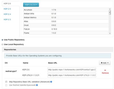

There is now a redhat-ppc7 public repo suggested by Ambari
Which configures HDP.repo and HDP-UTILS.repo in /etc/yum.repos.d.. The contents of which are:

--2017-09-04 16:20:53--  http://public-repo-1.hortonworks.com/HDP-UTILS-1.1.0.21/repos/ppc64le/repodata/repomd.xml
Connecting to x.x.x.x:3128... connected.
Proxy request sent, awaiting response... 200 OK
Length: 2583 (2.5K) [text/xml]
Saving to: ‘repomd.xml’
100%[=========================================================================>] 2,583       --.-K/s   in 0s
2017-09-04 16:20:53 (822 MB/s) - ‘repomd.xml’ saved [2583/2583]
