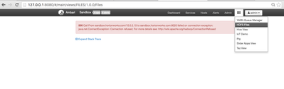

This may be a very basic question. i am just getting started with the devops in ambari. So, I am unable to start the HDFS service on ambari. I tried manually restarting all the components of HDFS from 'service actions' widget. Attched screen-shot-2016-04-29-at-14858-pm.pngscreen-shot-2016-04-29-at-21145-pm.pngscreen-shot-2016-04-29-at-21436-pm.pngpics

looks like the cnnection exception What does this mean?
Guru
It means namenode is not running. You need to paste the full NN log to see why it hasn't started. Please upload either the full NN log or the last 20 lines from there.
