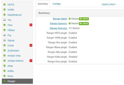

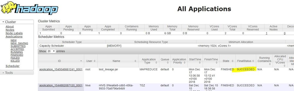

@Bhushan Kandalkar
I have just validated the process and it works, especially the sqoop import please see attached pdf. I suspect you don't have kafka installed if yes it isn't started
  • HDP 2.6.5.0-292
  • Ranger plugins all enable except kafka (no kerberos)
  • Kafka running
Validate that you have Kafka running I didn't see the below output
18/12/17 13:37:08 INFO kafka.KafkaNotification: ==> KafkaNotification()
18/12/17 13:37:08 INFO kafka.KafkaNotification: <== KafkaNotification()
18/12/17 13:37:08 INFO hook.AtlasHook: Created Atlas Hook
18/12/17 13:37:12 INFO kafka.KafkaNotification: ==>
KafkaNotification.createProducer()
18/12/17 13:37:12 INFO producer.ProducerConfig: ProducerConfig values:
acks = 1
batch.size = 16384
bootstrap.servers = [nanyuki.kenya.ke:6667]
Hope that helps, please revert
