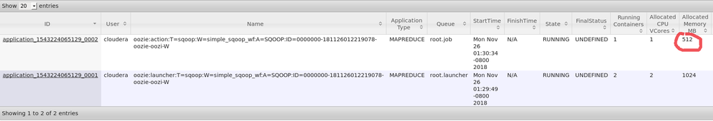

If I got it correctly these parameters
  • oozie.launcher.mapreduce.map.java.opts
  • oozie.launcher.mapreduce.reduce.java.opts
  • oozie.launcher.yarn.app.mapreduce.am.command-opts
control the maximum amount of memory allocated for the Oozie launcher.
What are the equivalent parameters to control the memory allocated for the action instead (e.g. a Sqoop action), as shown in the image?
