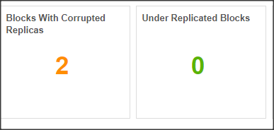

I've noticed in Ambari under HDFS metrics that we have 2 blocks with corrupt replicas.
Running " hdfs fsck / " shows no corrupt blocks and system is healthy.
Running "hdfs dfsadmin-report" shows 2 corrupt replicas (same as Ambari dashboard)
I've restarted Ambari metrics & Ambari Agents on all nodes + Ambari-server as noted in one of the threads i came across but still - problem remains.
