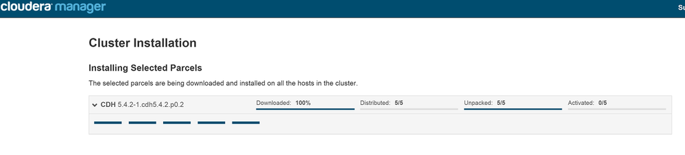

After I removed from the complete cluster and all services (agent, scm server) and deleted the directories the new installation stops in this point
with no progress.
Distributed 5/5
Unpacked 5/5
Activated 0/5
Any ideas what could be the problem?

The activation involves unpacking the parcel in /opt/cloudera/parcels and setting the symlinks. Check the Cloudera Manager agent logs for any errors. They're under /var/log/cloudera-scm-agent

This could be a defect. I reloaded the page from browser and it simply took me to next step !

in my case opend jdk is causing the issue once i removed them and installed the correct version of JDK the distribution completed successfully
