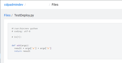

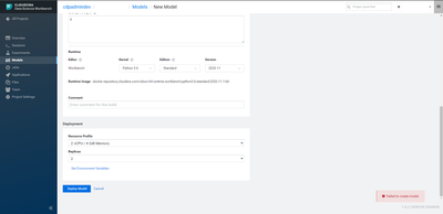

Hi All,
I get the following issue when deploy model to CDSW UI, when I try to deploy a model, the problem that appears is a notification failed to create model
Example python file to deploy
When I try to check the deploy result, the result is initial revision
is there anything that needs to be changed? or maybe someone knows where the log is to see deploy errors on cdsw
Thanks

Any luck on this? I get the same "Unable to load build output." error and I have no means to troubleshoot.

@NajAb8 / @seanbenner ,
Do you see anything in the "Monitoring" tab?
Cheers,
André

It says "There are no active model replicas at this time."

Have you trying stopping and starting the model? Or redeploying it?

Also, running the command "cdsw logs" as root on the CDSW host will collect logs from the CDSW containers, which you can use to troubleshoot.

This may be related to insufficient resources on your environment.
Could you share a screenshot of the Cluster Metrics table you can find under Admin > Overview?
On that same page you can also find a link to a Grafana Dashboard where you can check the resource utilisation at various levels.
