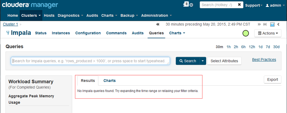

The Cloudera Manager Impala service don't show the queries..

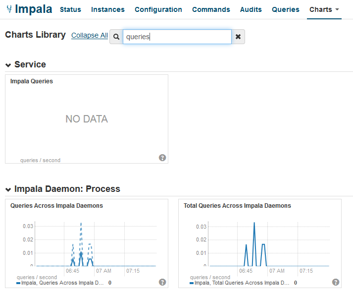

In "Impala Best Practices", all charts shown "NO DATA".
chart library "Impala queries" can not be shown
The CDH & CM version is 5.4.0(installation by path C), Centos6.6
I have reinstalled the CM and all services, the problem still exists.
The CM TimeZone is Error. But in the OS, the time zone is correct.
I don't know how to fix that.
Finally, I fixed the hwclock time, the probem has been solved.
