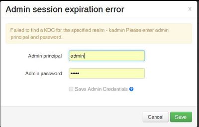

also I keep getting this error , whats the solution ? in this screen its not accepting kadmin/admin but only K/M

here is my krb5.conf file
[root@hadoop1 ~]# cat /etc/krb5.conf
[libdefaults]
  renew_lifetime = 7d
  forwardable = true
  default_realm = TOLLS.DOT.SATE.FL.US
  ticket_lifetime = 24h
  dns_lookup_realm = false
  dns_lookup_kdc = false
  default_ccache_name = /tmp/krb5cc_%{uid}
  #default_tgs_enctypes = aes des3-cbc-sha1 rc4 des-cbc-md5
  #default_tkt_enctypes = aes des3-cbc-sha1 rc4 des-cbc-md5
[logging]
  default = FILE:/var/log/krb5kdc.log
  admin_server = FILE:/var/log/kadmind.log
  kdc = FILE:/var/log/krb5kdc.log
[realms]
  TOLLS.DOT.SATE.FL.US = {
    admin_server = hadoop1.tolls.dot.state.fl.us
    kdc = hadoop1
[root@hadoop1 ~]#
kdc = hadoop1
should probably be
kdc = hadoop1.tolls.dot.state.fl.us
