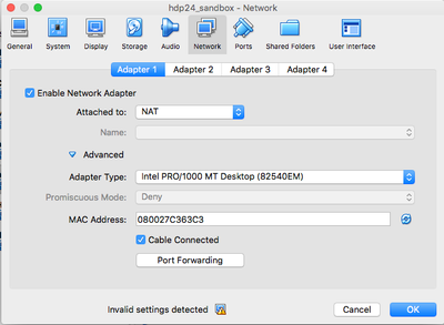

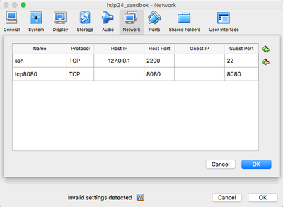

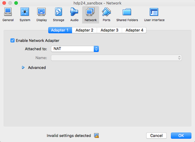

@jknulst
You should be using NAT for the network setting. The piece you need to check is Port Forwarding. You can find it under Network -> Advanced -> Port Forwarding. In my screenshot, I have port forwarding set to 2200<->22. By default the Sandbox is 2222<->22. This is because I'm using Vagrant with my sandbox.
I have provided a couple of screenshots:

@jknulst

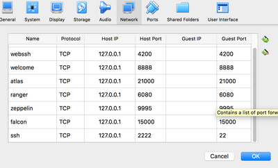

Super Collaborator
In addition to Michaels answer...
this is the complete list of ports forwarded if you messed those settings up somehow:
Don't forget to forward port 8080 as well, it is just off the screen.
