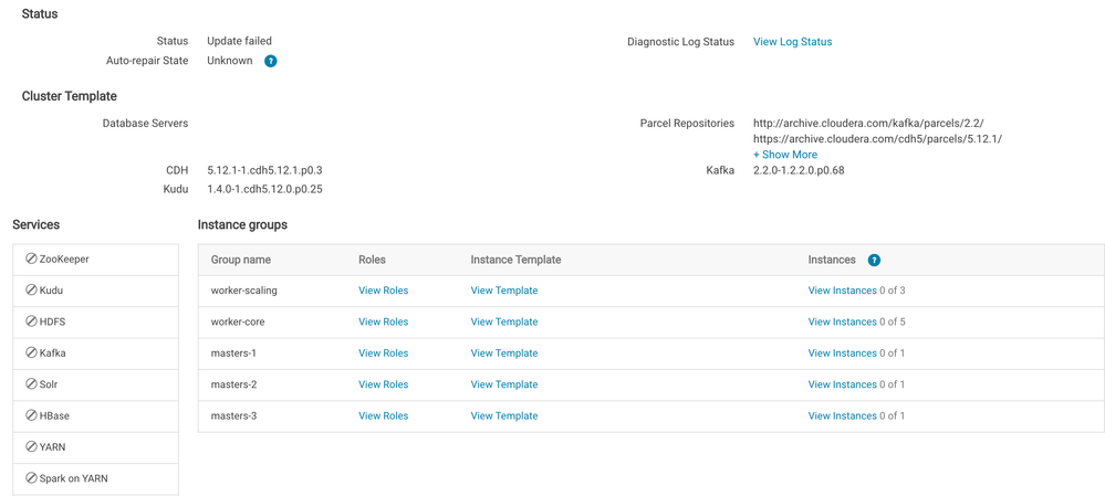

Hi.
I have a 10 node CDH cluster that I've deployed using Clouder Director (2.6) client remote-bootstrap. I've since upgraded Cloudera Manager and CDH from 5.12.1 to 5.13.0. Cloudera Director does not reflect the new cluster version. Instead, it shows the parcel versions the cluster was originally bootstrapped with.
How can I update Cloudera Director to reflect the correct version of my cluster?

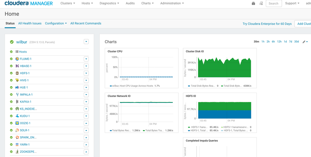

Created on 11-14-2017 08:14 AM - edited 11-14-2017 10:19 AM
I can see queries from my Director server in the Cloudera Manager logs - so it would appear they are still talking to one another. Director reports the cluster as healthy, but doesn't reflect the new version. After the failed attempt to add a worker node using Director UI (mentioned in my other post ) Director console no longer reports the status of my cluster services, nor do I have any available cluster actions other than clone / terminate. I don't even have the option to clean up the failed worker node from Director UI. Meanwhile, the cluster is healthy as reported by Cloudera Manager UI.

Cloudera Manager:
According to this page, Director should refresh it's information after an upgrade of a CDH cluster. I waited at least an hour after the upgrade before checking Cloudera Director and trying to "grow" my worker nodes.
