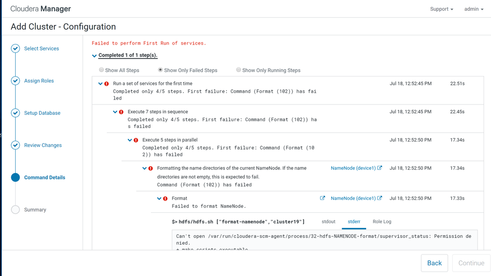

I wanna add a new server to cluster. But there was an issue in the last link.
My namenode is device1, and I was going to add device2 to the cluster.
The information printed as below:
Failed to perform First Run of services.
Completed 1 of 1 step(s).
  Show All Steps    Show Only Failed Steps    Show Only Running Steps
Run a set of services for the first time
Completed only 4/5 steps. First failure: Command (Format (102)) has failed
Jul 18, 12:52:45 PM	22.51s
Execute 7 steps in sequence
Jul 18, 12:52:45 PM	22.45s
Execute 5 steps in parallel
Jul 18, 12:52:50 PM	17.34s
Formatting the name directories of the current NameNode. If the name directories are not empty, this is expected to fail.
NameNode (device1)
Format
Failed to format NameNode.
NameNode (device1)
Jul 18, 12:52:50 PM	17.33s
$> hdfs/hdfs.sh ["format-namenode","cluster19"]
stdout
stderr
Role Log
Can't open /var/run/cloudera-scm-agent/process/32-hdfs-NAMENODE-format/supervisor_status: Permission denied.

Running in non-interactive mode, and data appears to exist in Storage Directory /dfs/nn. Not formatting.
screenshotscreenshot

Can't open /var/run/cloudera-scm-agent/process/40-hdfs-NAMENODE-format/supervisor_status: Permission denied.

+ exec /opt/cloudera/parcels/CDH-6.2.0-1.cdh6.2.0.p0.967373/lib/hadoop-hdfs/bin/hdfs --config /var/run/cloudera-scm-agent/process/40-hdfs-NAMENODE-format namenode -format -clusterId cluster19 -nonInteractive
WARNING: HADOOP_PREFIX has been replaced by HADOOP_HOME. Using value of HADOOP_PREFIX.
WARNING: HADOOP_NAMENODE_OPTS has been replaced by HDFS_NAMENODE_OPTS. Using value of HADOOP_NAMENODE_OPTS.
Contributor
I solved it by cleaning the /dfs/nn and /dfs/dn  because once I installed hdfs, and there were some data existed in the hdfs.
