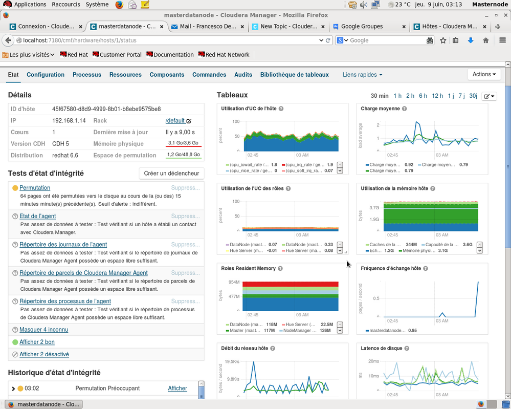

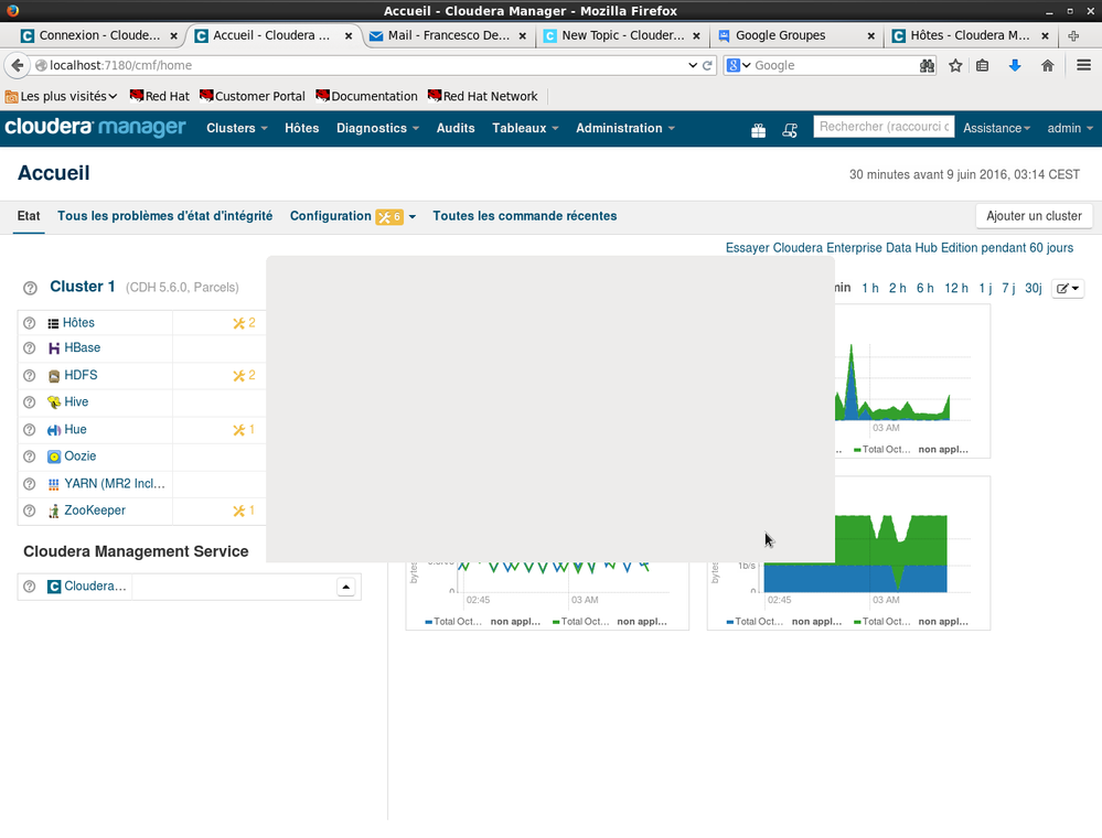

Hi Everyone !
After leaving CM not used for a week during a holiday I returned to an unknown health status issue
Everything was up and running fine before !
I have successfully got up and running a 3 node CDH Cluster with 4 go RAM in each and also 1 TB hard disc space for each (I am to add a fourth node soon) .
Hostnames are Childnode1, Childnode2 and Masterdatanode. Masterdatanode has Cloudera Manager installed
I have attached the screen shots of the CM UI's and the host and welcome pages (note they are in French)
I often see in the health check explanations:Not enough data to test: Test to verify if a host has established contact with Cloudera Manager
ie In French :Pas assez de données à tester : Test vérifiant si un hôte a établi un contact avec Cloudera Manager.
As you can see from the screenshots all services are up and running
I sometimes get the message on start up (When there are no charts and tables)
" Internal error while querying the host monitor "
But this goes away when I restart Cloudera Management services
Cloudera Manager server and agents are okay the agents are heartbeating normally as you can see from the hosts page screenshot
There must be something straight forward wrong as all icons show unknown health status (little question mark)
Can someone offer some help ?

Hello, while I cannot see your attached screenshots yet, this type of condition is usually caused when one (or both) of the roles
- Service Monitor
- Host Monitor
are not running. These roles are responsible for gathering and displaying the state of everything else within the cluster, so when you see no charts or tables, the immediate subject of review should be these two roles. You explain that restarting the Cloudera Management Services sometimes resolves the issue temporarily; Host Monitor and Service Monitor are roles under the Cloudera Management Service so that would explain why the full restart clears the issue for a time.
In the case of this smaller cluster you are running, it is likely Host Monitor and Service Monitor experienced an Out of Memory exception and have unexpectedly exited. Increasing heap configuration could help there.
I will check again soon to see if I can view your screenshots and provide a more full answer.
