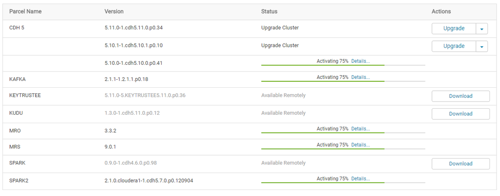

Hi
Recently i have resized the disks on the node and restarted the cluster. My parcels screen looks like below. I have to install spark 2 and kafka, can you please suggest how to resolve this issue
The parcels are in activating state for 2 days.

It was due to the rogue node. i had to delete that node from cluster. This is fine now.

You can also try restarting the CM service to see if that stops the process. I'd be interested if it has actually finished the process on all nodes. You can check the /opt/cloudera/parcels directory to see if the symlink to the version being activated is in place.
