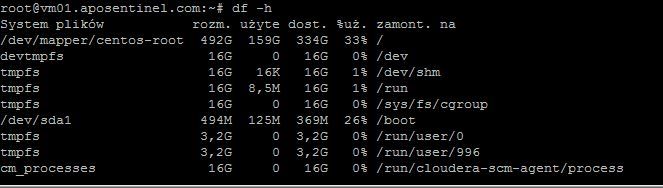

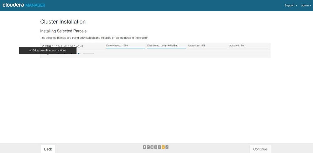

I've been trying to install Cloudera 5.10 on Centos 7.x in a VMWare environment.  Each time Cloudera Manager gets stuck at Distributed.  Only 2 nodes are correct.
 Disk space is not a constraint
 selinux, ipv6, firewalls are disabled

The same happened when I was trying to install cloudera by package, only two nodes were correct...
Any help will be appreciated

New Contributor
Thanks,
Removing all alternatives OpenJDK helped:)
