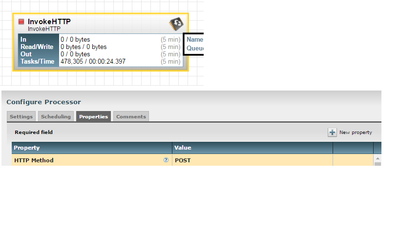

I did this and see the task and time is increasing but no change in bytes.
I used POST method because I saw the following . Does any property on header needs to be set
Request an access token by sending your Client ID and Client Secret via HTTP Basic Authentication, using an HTTP POST request
Please add a GenerateFlowFile processor before InvokeHttp processor, and connect GFF to InvokeHttp. You need to have flow files generated going into InvokeHttp processor to have requests performed against your API.
You are correct for the method if your API asks for a POST method.
