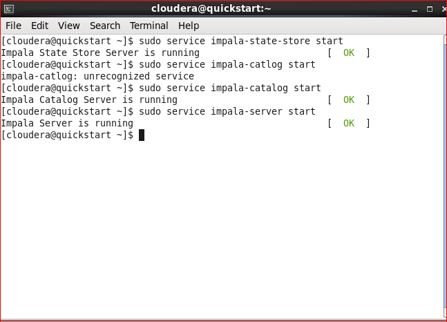

1) I have installed cloudera imapala in a virtaul box. I can create data tables in it inside the database - "default".
2) The virtual box is present on my local machine and when I am trying to access it, it is throwing me the error message -
FAILED!
[Cloudera][ImpalaODBC] (100) Error from the Impala Thrift API: connect() failed: errno = 10061
