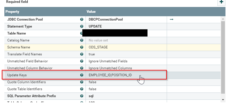

Eg: Update table table_name emp_name=? where empid=?
But My column name is emp_id

Finally fixed the issue by myself. have changed all the columns to Uppercase and made the Translate Field Names to false.. That works for me.

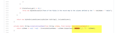

Anybody has answer for this- I get this issue on PutDatabaseRecord as well. When I check java code of PutDatabaseRecord. I could see below  replace with - underscore.

I set the Translate Field Names to false, it started working, before this it was converting the primary key field to upper case, removing the underscore, so when I run the putSQL, it was throwing error, working fine now, thanks to your answer!
