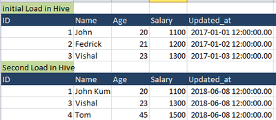

Master Guru
@Raj ji
We cannot load the sample table that you have shared incrementally because
let's take you have used QueryDatabaseTable and given max value column as id then processor will pulls(id's 1,2,3) in the first run and stores the state as 3 after the first run.
Second run processor pulls only the records that are greater than id>3 now we are not able to pull 1,3 records as they are updated ,Processor will pull only id=4 and updates the state to 4.
1.How can we pull data incrementally from RDBMS table then?
Let's consider your table having one more extra column i.e update_at(timestamp type) this field will be updated with system timestamp when there is new records inserted/created in the table (or) records got updated in the table.
Initially you are having 3 records that are created at 2017-01-01 12:00:00.00 and then id's 1,3 updated and 4 created with new updated_at timestamp i.e 2018-06-08 12:00:00.00.
Now you have configured QueryDatabaseTable processor with max value column as updated_at so
  • first run processor pulls all the id's(1,2,3) and updates the state as 2017-01-01 12:00:00.00
  • next run processor checks for any updated values after 2017-01-01 12:00:00.00 if it founds then pulls all the records and updates the state to 2018-06-08 12:00:00.00(in our case).
By using this table structure we are going to capture all the updates that are happening on the source table to Hive table.
2.On the second load , We have to remove the values 3 and update the value 1 and insert the value 4 . How that is possible in Nifi . Is that at possible ?
Update/Deletes in Hive through NiFi is not yet possible(hive natively don't support update/deletes) every thing will be appends to the hive table.

New Member
Hi
@Shu
I was able to establish a connection between mysql and Hive . However the purpose is not solved yet . I was trying to update and insert values into Hive . For Example ( refer attached) .
In the example : . On Initial load Hive has loaded the values of ID 1,2 and 3 . On the second load , We have to remove the values 3 and update the value 1 and insert the value 4 . How that is possible in Nifi . Is that at possible ?
Could please guide me on this If you can.
thanks ...
