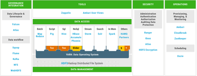

Apache Hadoop is just a major component of HDP (Hortonworks Data Platform). HDP includes a lots of other components in it. HDP is a suit of components that are tested and certified to work together.
Please see the image explaining HDP in the following link: https://hortonworks.com/products/data-center/hdp/
Where as the HDF (Hortonworks Data Flow) includes the following: HDF includes the following services: NiFi, Storm, Kafka, Zookeeper, Ambari, Ranger
