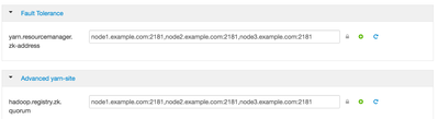

1. Yes. You can have multiple instances of zookeeper using ambari.
2. You can have one zookeeper for solr and other zookeeper for rest of other service.
You need to make sure you need to specify zookeeper quorum with zookeeper name within config properties of every service.
Eg. Below screenshot is for Yarn service - where zookeeper will be replace with your respective zk node name.
