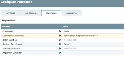

You can use ExecuteProcess (doesn't allow any incoming connections) (or) ExecuteStreamCommand processors to trigger the shell script.
ExecuteProcess configs:
As your executable script is on Machine 4 and NiFi installed on Machine1 so create a shell script on Machine 1 which ssh into Machine 4 and trigger your Python Script.
Refer to this and this links describes how to use username/password while doing ssh to remote machine.
As you are going to store the logs into a file, so you can use Tail file processor to tail the log file and check is there any ERROR/WARN, by using RouteText Processor then trigger mail.
