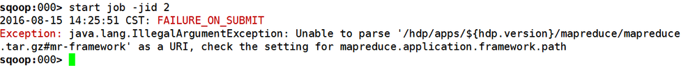

I have a problem, somebody can help me?
My softwares are Sqoop-1.99.6 HDP-2.4.0.0-169
I used sqoop to start a job,i got a problem like this:
Who can help me,please!
Thank you !

and i found this
which is mean that in the directory"/hdp/apps/${hdp.version}/mapreduce/", No "mapreduce.tar.gz" package
