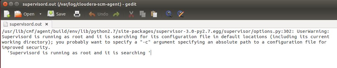

The cloudera-scm-agent.out:

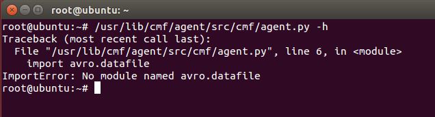

Using the help hint:

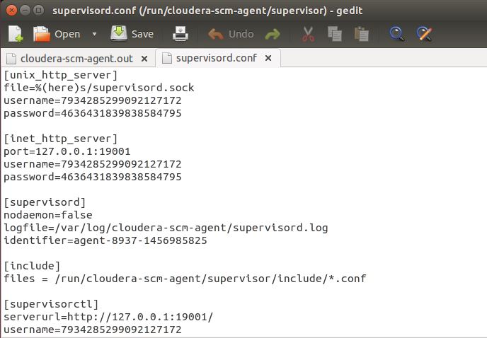

The supposedly missing config file exists:

[03/Mar/2016 07:17:05 +0000] 8937 MainThread agent        INFO     Setting up supervisord event monitor.
[03/Mar/2016 07:17:05 +0000] 8937 MainThread filesystem_map INFO     Monitored nodev filesystem types: ['nfs', 'nfs4', 'tmpfs']
[03/Mar/2016 07:17:05 +0000] 8937 MainThread filesystem_map INFO     Using timeout of 2.000000
[03/Mar/2016 07:17:05 +0000] 8937 MainThread filesystem_map INFO     Using join timeout of 0.100000
[03/Mar/2016 07:17:05 +0000] 8937 MainThread filesystem_map INFO     Using tolerance of 60.000000
[03/Mar/2016 07:17:05 +0000] 8937 MainThread filesystem_map INFO     Local filesystem types whitelist: ['ext2', 'ext3', 'ext4']
[03/Mar/2016 07:17:05 +0000] 8937 MainThread kt_renewer   INFO     Agent wide credential cache set to /run/cloudera-scm-agent/krb5cc_cm_agent_0
[03/Mar/2016 07:17:05 +0000] 8937 MainThread agent        INFO     Using metrics_url_timeout_seconds of 30.000000
[03/Mar/2016 07:17:05 +0000] 8937 MainThread agent        INFO     Using task_metrics_timeout_seconds of 5.000000
[03/Mar/2016 07:17:05 +0000] 8937 MainThread agent        INFO     Using max_collection_wait_seconds of 10.000000
[03/Mar/2016 07:17:05 +0000] 8937 MainThread metrics      INFO     Importing tasktracker metric schema from file /usr/lib/cmf/agent/src/cmf/monitor/tasktracker/schema.json
[03/Mar/2016 07:17:05 +0000] 8937 MainThread ntp_monitor  INFO     Using timeout of 2.000000
[03/Mar/2016 07:17:05 +0000] 8937 MainThread dns_names    INFO     Using timeout of 30.000000
[03/Mar/2016 07:17:05 +0000] 8937 MainThread __init__     INFO     Created DNS monitor.
[03/Mar/2016 07:17:05 +0000] 8937 MainThread stacks_collection_manager INFO     Using max_uncompressed_file_size_bytes: 5242880
[03/Mar/2016 07:17:05 +0000] 8937 MainThread __init__     INFO     Importing metric schema from file /usr/lib/cmf/agent/src/cmf/monitor/schema.json
[03/Mar/2016 07:17:05 +0000] 8937 MainThread agent        INFO     Supervised processes will add the following to their environment (in addition to the supervisor's env): {'CDH_PARQUET_HOME': '/usr/lib/parquet', 'JSVC_HOME': '/usr/libexec/bigtop-utils', 'CMF_PACKAGE_DIR': '/usr/lib/cmf/service', 'CDH_HADOOP_BIN': '/usr/bin/hadoop', 'MGMT_HOME': '/usr/share/cmf', 'CDH_IMPALA_HOME': '/usr/lib/impala', 'CDH_YARN_HOME': '/usr/lib/hadoop-yarn', 'CDH_HDFS_HOME': '/usr/lib/hadoop-hdfs', 'PATH': '/usr/local/sbin:/usr/local/bin:/usr/sbin:/usr/bin:/sbin:/bin:/usr/games:/usr/local/games', 'CDH_HUE_PLUGINS_HOME': '/usr/lib/hadoop', 'CM_STATUS_CODES': u'STATUS_NONE HDFS_DFS_DIR_NOT_EMPTY HBASE_TABLE_DISABLED HBASE_TABLE_ENABLED JOBTRACKER_IN_STANDBY_MODE YARN_RM_IN_STANDBY_MODE', 'KEYTRUSTEE_KP_HOME': '/usr/share/keytrustee-keyprovider', 'CLOUDERA_ORACLE_CONNECTOR_JAR': '/usr/share/java/oracle-connector-java.jar', 'CDH_SQOOP2_HOME': '/usr/lib/sqoop2', 'KEYTRUSTEE_SERVER_HOME': '/usr/lib/keytrustee-server', 'CDH_MR2_HOME': '/usr/lib/hadoop-mapreduce', 'HIVE_DEFAULT_XML': '/etc/hive/conf.dist/hive-default.xml', 'CLOUDERA_POSTGRESQL_JDBC_JAR': '/usr/share/cmf/lib/postgresql-9.0-801.jdbc4.jar', 'CDH_KMS_HOME': '/usr/lib/hadoop-kms', 'CDH_HBASE_HOME': '/usr/lib/hbase', 'CDH_SQOOP_HOME': '/usr/lib/sqoop', 'WEBHCAT_DEFAULT_XML': '/etc/hive-webhcat/conf.dist/webhcat-default.xml', 'CDH_OOZIE_HOME': '/usr/lib/oozie', 'CDH_ZOOKEEPER_HOME': '/usr/lib/zookeeper', 'CDH_HUE_HOME': '/usr/lib/hue', 'CLOUDERA_MYSQL_CONNECTOR_JAR': '/usr/share/java/mysql-connector-java.jar', 'CDH_HBASE_INDEXER_HOME': '/usr/lib/hbase-solr', 'CDH_MR1_HOME': '/usr/lib/hadoop-0.20-mapreduce', 'CDH_SOLR_HOME': '/usr/lib/solr', 'CDH_PIG_HOME': '/usr/lib/pig', 'CDH_SENTRY_HOME': '/usr/lib/sentry', 'CDH_CRUNCH_HOME': '/usr/lib/crunch', 'CDH_LLAMA_HOME': '/usr/lib/llama/', 'CDH_HTTPFS_HOME': '/usr/lib/hadoop-httpfs', 'CDH_HADOOP_HOME': '/usr/lib/hadoop', 'CDH_HIVE_HOME': '/usr/lib/hive', 'CDH_HCAT_HOME': '/usr/lib/hive-hcatalog', 'CDH_KAFKA_HOME': '/usr/lib/kafka', 'CDH_SPARK_HOME': '/usr/lib/spark', 'TOMCAT_HOME': '/usr/lib/bigtop-tomcat', 'CDH_FLUME_HOME': '/usr/lib/flume-ng'}
[03/Mar/2016 07:17:05 +0000] 8937 MainThread agent        INFO     To override these variables, use /etc/cloudera-scm-agent/config.ini. Environment variables for CDH locations are not used when CDH is installed from parcels.
[03/Mar/2016 07:17:05 +0000] 8937 MainThread agent        INFO     Created /run/cloudera-scm-agent/process
[03/Mar/2016 07:17:05 +0000] 8937 MainThread agent        INFO     Chmod'ing /run/cloudera-scm-agent/process to 0751
[03/Mar/2016 07:17:05 +0000] 8937 MainThread agent        INFO     Created /run/cloudera-scm-agent/supervisor
[03/Mar/2016 07:17:05 +0000] 8937 MainThread agent        INFO     Chmod'ing /run/cloudera-scm-agent/supervisor to 0751
[03/Mar/2016 07:17:05 +0000] 8937 MainThread agent        INFO     Created /run/cloudera-scm-agent/supervisor/include
[03/Mar/2016 07:17:05 +0000] 8937 MainThread agent        INFO     Chmod'ing /run/cloudera-scm-agent/supervisor/include to 0751
[03/Mar/2016 07:17:05 +0000] 8937 MainThread agent        ERROR    Failed to connect to previous supervisor.
Traceback (most recent call last):
  File "/usr/lib/cmf/agent/src/cmf/agent.py", line 1660, in find_or_start_supervisor
    self.configure_supervisor_clients()
  File "/usr/lib/cmf/agent/src/cmf/agent.py", line 1907, in configure_supervisor_clients
    supervisor_options.realize(args=["-c", os.path.join(self.supervisor_dir, "supervisord.conf")])
  File "/usr/lib/cmf/agent/build/env/lib/python2.7/site-packages/supervisor-3.0-py2.7.egg/supervisor/options.py", line 1578, in realize
    Options.realize(self, *arg, **kw)
  File "/usr/lib/cmf/agent/build/env/lib/python2.7/site-packages/supervisor-3.0-py2.7.egg/supervisor/options.py", line 312, in realize
    self.process_config()
  File "/usr/lib/cmf/agent/build/env/lib/python2.7/site-packages/supervisor-3.0-py2.7.egg/supervisor/options.py", line 320, in process_config
    self.process_config_file(do_usage)
  File "/usr/lib/cmf/agent/build/env/lib/python2.7/site-packages/supervisor-3.0-py2.7.egg/supervisor/options.py", line 355, in process_config_file
    self.usage(str(msg))
  File "/usr/lib/cmf/agent/build/env/lib/python2.7/site-packages/supervisor-3.0-py2.7.egg/supervisor/options.py", line 143, in usage
    self.exit(2)
SystemExit: 2
