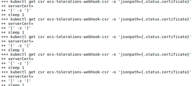

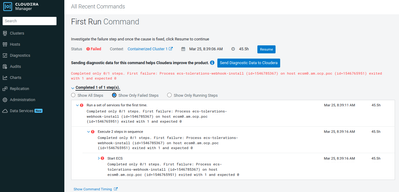

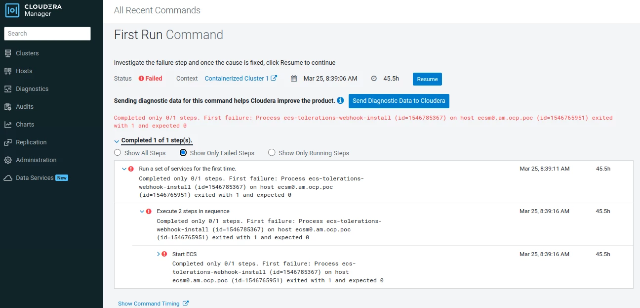

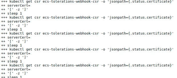

During the installation of ECS, we encountered some errors that prevented successful installation. One of the issues was as follows: the Certificate Signing Request (CSR) remained in an "approved" state instead of being "certificated," causing it to remain stuck in a loop.

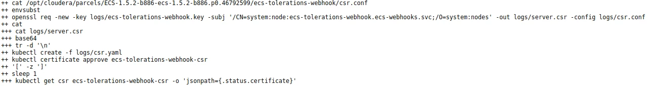

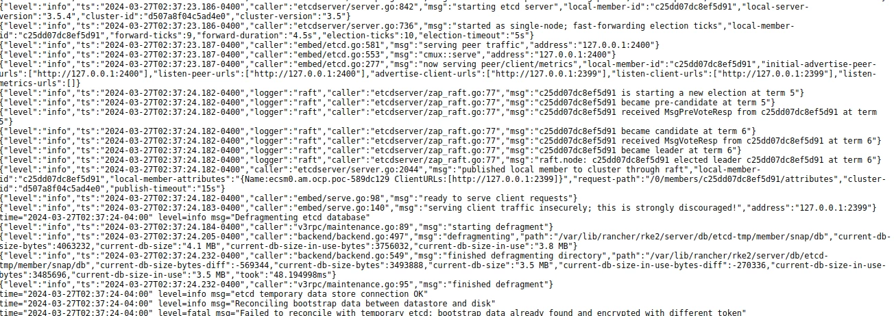

However, we encountered another problem:
time="2024-03-27T02:37:24-04:00" level=info msg="etcd temporary data store connection OK"
time="2024-03-27T02:37:24-04:00" level=info msg="Reconciling bootstrap data between datastore and disk"
time="2024-03-27T02:37:24-04:00" level=fatal msg="Failed to reconcile with temporary etcd: bootstrap data already found and encrypted with different token"
After deleting the etcd path on the Rancher master, we were able to proceed past this issue.
rm -f -r /var/lib/rancher/rke2/server/db/etcd-tmp/
rm -f -r /var/lib/rancher/rke2/server/db/etcd/
Is deleting the etcd path a safe and viable solution? Or are there other considerations or alternative methods to address this problem?

Hello @steinsgate
Thanks for bringing up this issue
Yes as part of uninstallation, we need to remove the rancher directories as well. Currently, this was missing from the documentation but now will be added soon.
rm -rf /var/lib/rancher/*
So as part of  uninstallation, it should be done and should be safe
