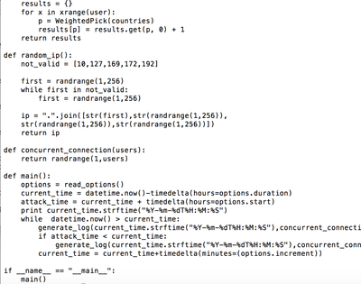

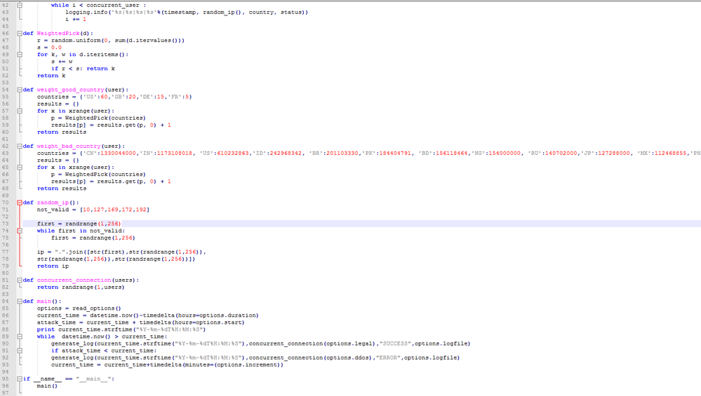

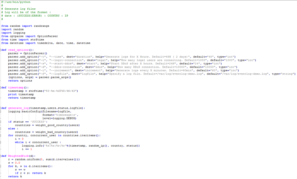

@Benjamin Leonhardi Same error message received. Below is what is in the script which I re-downloaded and unzipped. I would paste the code from the script but it exceeds the 600 character limit. Instead Ive attached pictures. I see no issues with indentation of return statements nor do I see anything on line 98.

Can you have a look at the file in the sandbox ( cat vi ). Might be different from windows ( Thats notepad++ right? )

@Benjamin Leonhardi Interesting! You are right, I was using Notepadd++. However, when I opened the script in vi, there are additional lines not visible in Notepad++. See the attached picture. I changed the return on line 98 to be commented as suggested on the tutorial comments and the script executed.py3.png

Did it also generate the logs? Its a bit weird, that is what I just downoaded from the tutorial link:
So for me it needed the return, it needs to be in the same line as the for and I don't have the main at the top you have.
