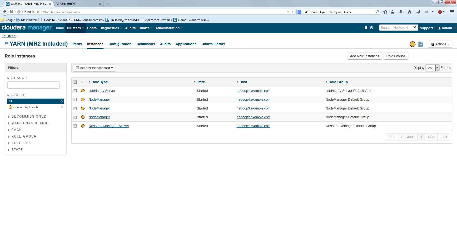

I'm following this example using Java:
http://blog.cloudera.com/blog/2014/04/how-to-run-a-simple-apache-spark-app-in-cdh-5/
Everything works fine when using "-master local" option, but I'm getting error when trying to run on YARN ("-master yarn").
I'm running a CDH 5.2.0 cluster with 4 VMs (8GB RAM in master node and 2GB on the others).
Am I running the Job in correct way to have it running over the four nodes? What's the differece to use ("-master spark://IP:Port") and what is the default port to run this way?
Here is the full console output when trying to run on YARN:

Hi Srowen, thanks for the reply. I discovered the problem and its was related with memory limits in YARN configuration. Now I can run my job, but I still having a doult:
I have four nodes on the cluster, but the job is running in only two of them. Why is that? I'm firing the job from hadoop1 shell and the job is running only with nodes 3 and 4. Node 2 became the driver. How can I better use my resources?
Here is my YARN instances:
And here is my Job running:
