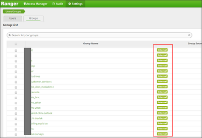

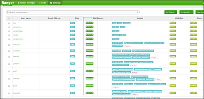

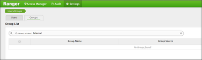

Here is the problem in screenshots:
Users from Active Directory and their respectable groups:
Groups are only "internal"
No external groups:
