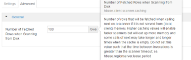

Hi ,
When i type "hbase.regionserver.lease.period" in Ambari configs the following property got invocated "Number of Fetched Rows when Scanning from Disk"
It looks we didn't set "hbase.regionserver.lease.period" in our Ambari conifgs.
Thanks.
