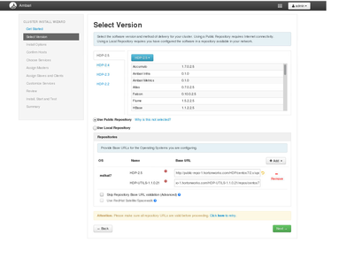

RHEL7.2, Installing HDP 2.5.3, Ambari GUI tells that the URL
http://public-repo-1.hortonworks.com/HDP/centos7/2.x/updates/2.5.3.0 is INVALID
BaseURL taken from https://docs.hortonworks.com/HDPDocuments/Ambari-2.4.2.0/bk_ambari-installation/content/hdp_25_repos...
The node has net connection
any idea?

screen shot

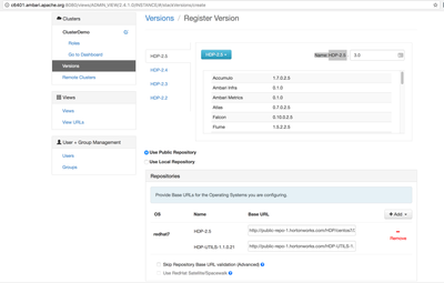

Master Mentor
You will need to register a new version first.
Are you defining the "Name" properly in the ambari UI while registering a new HDP 2.5 version?
Ambari UI --> Admin (Tab) --> 'Stack and Versions' --> "Versions" (tab) --> "Manage Version" (Button) --> "Register Version" --> From drop down button choose "HDP 2.5 Default Version Definition"
Then on the right side of this page you will see "Name: HDP-2.5." there you should define the version as 3.0 as mentioned in the screenshot.
Now you should be able to install a cluster on this newly register version.
