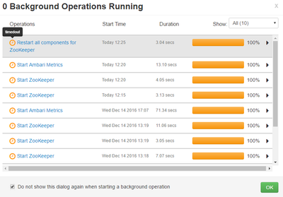

I need help because my sandbox environment are having a strange behavior. I can't start/stop/restart services neither through Ambari neither using the REST API. As the below screenshot shows, after few seconds Ambari get a timedout error.
Also the status of some services changes frequently without send any command. I updated the postgressql database to version 9.4, I reintalled the ambari-agent, delete temporary/cache files of ambari-server and ambari-agent.
I found that always there are some threads between Ambari and the database. Maybe these connections not let Ambari send more commands? I tried to kill all the process, but after a couple of seconds all threads appear again...
