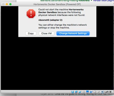

With latest Virtualbox (5.1.6) and HDP 2.5 Sandbox I get this VirtualBox Error:
"Could not start the machine Hortonworks Docker Sandbox because the following physical network interfaces were not found: vboxnet0 (adapter 2)"

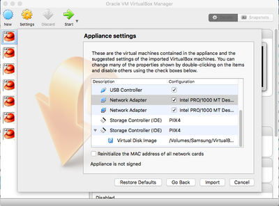

During import of the appliance file, VirtualBox will show you the VM configuration. You can uncheck the second network option, which is the one that uses the vboxnet0 adapter.

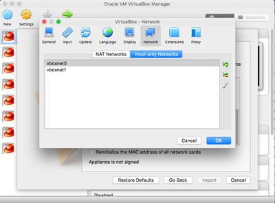

If you go to VirtualBox -> Preferences -> Network -> Host-only Networks you should see something like this (vboxnet0):
My guess is that you don't have vboxnet0 defined. You can add it from this screen.
