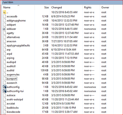

thanks Jay for the reply, but /usr/sbin/ambari-admin-password-reset is missing on the sandbox, and command ambari-start is not recognized, I guess ambari compoment location has been changed in this sandbox version and some environment values for shell need to update?

try using putty ssh to connect to the sandbox: host:127.0.0.1, user: root, password:hadoop, port:2222. that helps me solve the issue. The issue happened when login to sandbox from virtualbox directly using "alt+f5" for me.
Expert Contributor
@Preetha Varma,
as @Anna Qin stated, you will get to the sandbox by ssh-ing to port 2222. There are two levels of virtualization in the sandbox. The host VM, which runs on virtualbox, and the sandbox container, which runs under docker in the VM. The container is where all of the sandbox processes run. Port 2222 goes into the container and that is why ambari-admin-password-reset has to be run there.
