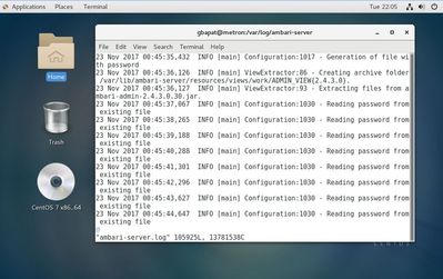

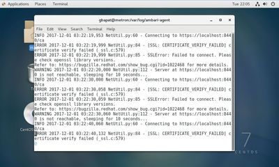

My logs and my ambari components heartbeat fail after sometime

Hi @Gaurav Bapat ,
This error seems to be becuase of python version
can you please refer to following thread
https://community.hortonworks.com/questions/120861/ambari-agent-ssl-certificate-verify-failed-certif...
I hope you issue is same.
Re: Heartbeat Lost: Hostname is not sending heartbeat
New Contributor
I have python 2.7.5 installed, do I need to downgrade it or upgrade it??
Is the SSL error because of Heartbeat and also why does my Metron component fails??
@akhilsnaik
Hi @Gaurav Bapat,
As you are using python 2.7.5
you might be hitting the same bug mentioned in about link.
You can refer to this Link . https://access.redhat.com/articles/2039753#controlling-certificate-verification-7 and try disabling the certificates.
