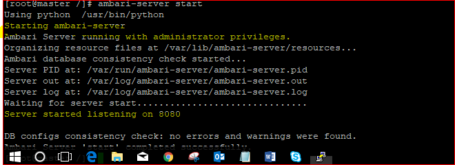

I deleted all vm instances and recreated them. have reinstalled amabari server . All gets installed clean - but doesn't start GUI . port 8080 also I do not see running on Linux .port8080.png..
[root@master /]# netstat -ano |grep 8080
tcp 0 0 :::8080 :::* LISTEN off (0.00/0/0)
tcp 0 0 ::1:8080 ::1:57354 TIME_WAIT timewait (37.78/0/0)
[root@master /]#
