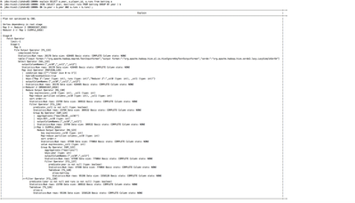

I'm running an explain on a query and the result includes "Plan not optimized by CBO due to missing statistics. Please check log for more details"
1. All the tables in the query have had compute statistics run on them and the describe formatted output shows that stats are present and up to date. What is missing?
2. Which log file is the message referring to? I looked in Hive the hiveserver2.log and can see the log entries for the explain command here but there's no explanation on what stats it thinks are missing.

Table is not partitioned.
create table batting (player_id STRING, year INT, runs INT);
Column stats = None
0: jdbc:hive2://phdns02:10000> analyze table batting compute statistics;
INFO : Session is already open
INFO : Dag name: analyze table batting compute statistics(Stage-0)
INFO :
INFO : Status: Running (Executing on YARN cluster with App id application_1448374612679_0002)
INFO : Map 1: 0/1
INFO : Map 1: 0(+1)/1
INFO : Map 1: 1/1
INFO : Table default.batting stats: [numFiles=1, numRows=95196, totalSize=1653324, rawDataSize=1558128]
No rows affected (6.775 seconds)
0: jdbc:hive2://phdns02:10000> analyze table batting compute statistics for columns ;
INFO : Dag name: analyze table batting compute stat...columns(Stage-0)
INFO :
INFO : Map 1: 0(+1)/1Reducer 2: 0/1
INFO : Map 1: 1/1Reducer 2: 0/1
INFO : Map 1: 1/1Reducer 2: 0(+1)/1
INFO : Map 1: 1/1Reducer 2: 1/1
No rows affected (3.131 seconds)

If you are getting message "plan not optimized by CBO" when your table has statistics, please, check your hive log and look if you don't have message below:
"parse.BaseSemanticAnalyzer: Not invoking CBO because the statement has too few joins"
This message in log mean CBO wasn't used just because it wasn't needed, as your query may have few joins. The warning message in explain is not clear, as it says only "plan not optimized by CBO", but it's not an issue if you see the extra message in log file.
Master Mentor
@Guilherme Braccialli "CBO because the statement has too few joins" I guess it means that "missing statistics" message is normal.
