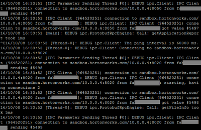

Relatively new to Hive/Hadoop. For the past two days,
I haven't been able to launch Hive and it's been stuck hanging after I try to start it from PuTTy. It hangs on
WARNING: Use "yarn jar" to launch YARN applications.
Logging initialized using configuration in file:/etc/hive/2.4.0.0-169/0/hive-log4j.properties
I've tried killing all Yarn Application tasks but that doesn't work. I've tried restarting my Ambari environment. I've tried debugging at Hive Launch but it just goes on forever. Launching in MapReduce (as opposed to Tez) gets it launched, but it isn't able to perform any operators after that (e.g. create table/ select count(*)). This is what it looks like when I debug at Hive launch (it never ends!):
I'd appreciate if someone could help me out or point me in some direction! Thanks

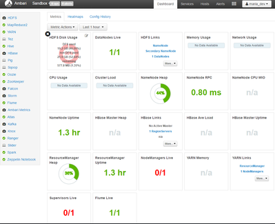

Super Guru
@Fabienwith the ambari dashboard view it looks it's a single node cluster and your nodemanger is down, can you restart it and run the query again.

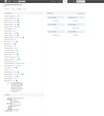

New Member
@Rajkumar Singh, thanks for the guidance. I can't find the "dropdown by selecting start". I see Nodemanager, but can't find the start option. See below.

Super Guru
@Fabien
could you please try login with the admin user instead of maria_dev.
